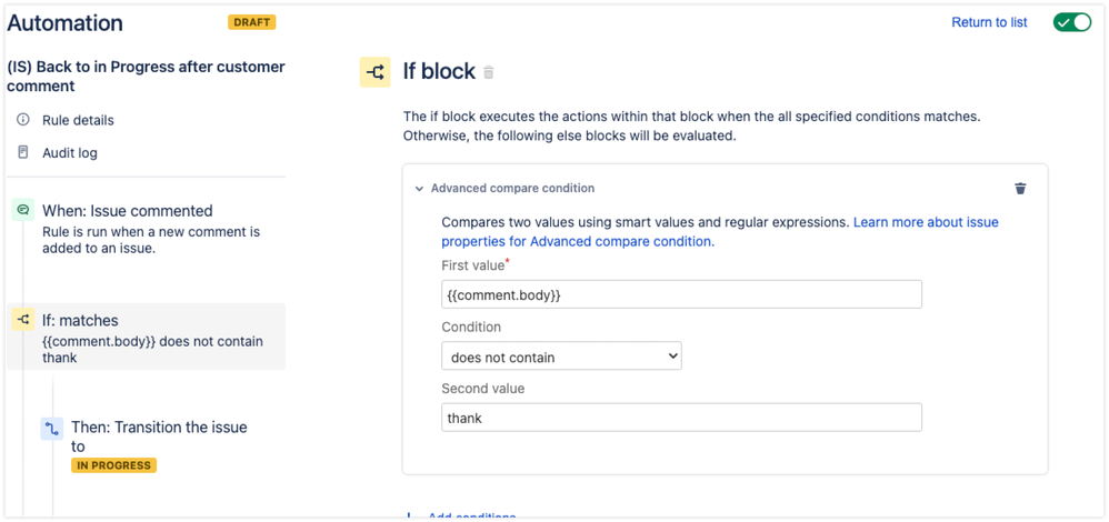

At a very basic level I could easily use the condition "does not contain" the word "thank" - which will work!

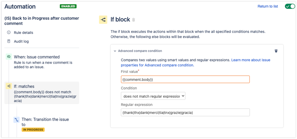

  • When using the condition "does not match regex" the issue will be re-opened no matter what the reply is - so even if the comment contains something from the regex
  • When using the condition "contains regex" OR "exactly machtes regex" the issue will remain resolved - no matter what the reply is

^(.*(tha?n?ks?|thx|dank*|merci|tia|tnx|grazie|gracia).*)$ /gi
However I realised 1-2 weeks ago that our issues won´t reopen and remain resolved. Therefore I started to investigate and ease our regex to the piped-example shown above.
Feels like as soon you enter any kind of regex the automation or condition does not work correctly anymore - of course maybe I am doing something totally wrong ;)

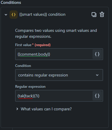

* If Condition:
Screenshot 2024-02-22 144005.png(Regex looks for "Thanks" in danish and swedish, with a case insensitivity flag)

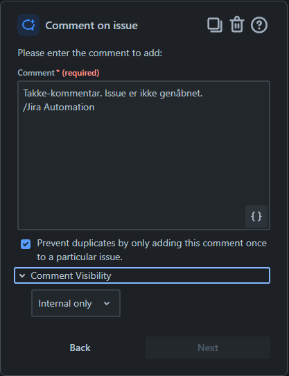

* Dummy action on the if condition: Screenshot 2024-02-22 144131.png

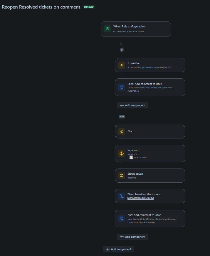

* My full tree looks like this, with the actions I actually wanna take if the regex DOESN'T match under "Else":
