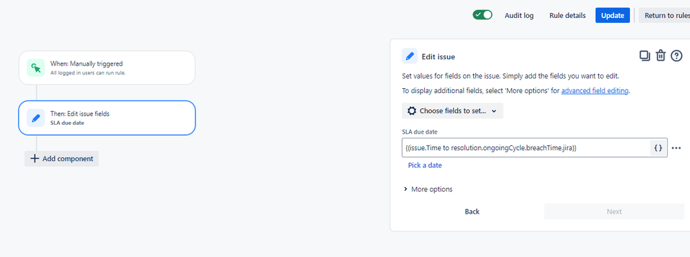

Is there any way of copying the sla data (for example: Oct 30, 10:30 PM ) to my custom field (format-- date time picker)
With Automation, you can use this smart value to update a custom field
Example for Time to resolution SLA
{issue.Time to resolution.ongoingCycle.breachTime.jira}}

Hi @Kris Dewachter
In the above example you mentioned the value can be stored as Nov 30 2024, 5:00 PM in my SLA
Now I want this date Nov 30 2024, 5:00PM to be copied in my custom field.
I was attaching the screenshot how my sla was popping
