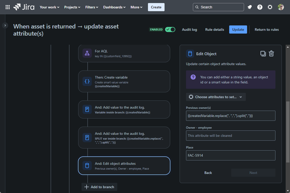

I'm not sure if you managed to resolve this or not, but I was doing the similar thing here (with previous owners of an object ("Previous owner(s)" is an object attribute where I append new values): https://community.atlassian.com/t5/Jira-Service-Management/Automation-AQL-branching-issue/qaq-p/2591669
In short, I had to create new variable within automation by using the following format:
{{object."Previous owner(s)"}},{{object."Owner - employee"}}
And this was followed up by using Edit object attributes automation action where for "Previous owner(s)" I used the following smart value:
{{createdVariable.replace(", ",",").split(",")}}
Hope this helps.
Cheers,
Tom
