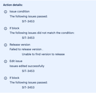

Hi @Bill Sheboy I've added a JQL but do not work. Not sure how to do it. This is the last error, and the screenshots of the rule. The first part is working fine, it is only the second part with the "on-prem" scenario.
With the Release Version action, an exact name must be given. It cannot search for a name using the CONTAINS ~ operator, like with JQL.
Based on what you described, you are trying to release the version assigned to the issue which has a name start containing the text SLM, and which is not yet released.
As the fix version field can contain multiple values, that will require multiple steps before the release action:
The first smart value for the variable works by iterating over the fix version field, saving any name, released status, and id values in a delimited list.
The second one splits the variable back apart, filtering on the name and released status first, and then extracting the id value for the version.
This technique will not work if there are multiple versions containing "SLM" assigned to the same issue.

I've tried your approach, and the result was that a "version release" was released but not added to the issue.
