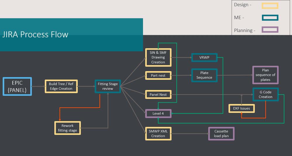

A bit of context about this, I created a kanban board where the manual creation of an EPIC drives the auto creation of a TASK, then subsequently the transition of that task to DONE then drives another auto creation task and so on.
So the epic is the parent of the 1st task. The 1st task is the parent of the 2nd task etc.

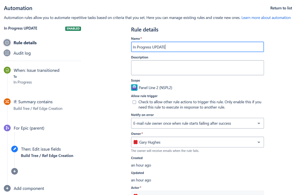

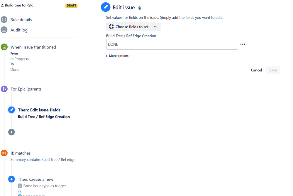

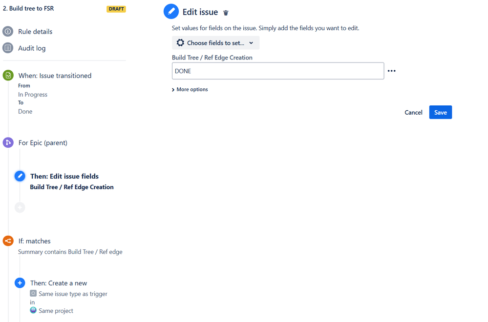

I have tried adding in a branch within the automation I already have which generates the subsequent task.
I have also tried setting up a separate rule which looks for when a task is transitioned, and has a summary field containing a certain name then it will update the epic field for that task name accordingly. I cant get these to work at all, even with the help of Chat GPT.
Please see the screenshots below which show my attempts at the automation, along with the flow of task creation for reference (each grey arrow shows when a new issue is auto created.

When build tree / ref edge TASK is transitioned to DONE and subsequently created the fitting stage review TASK, I would like to be able to then update the plain text field (called Build tree ref edge) within the original EPIC to either say 'DONE' or display the week number of the year or even todays date.

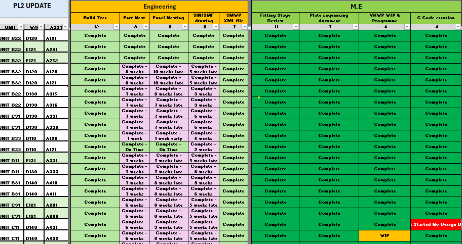

My goal is to create an EazyBI report which will have the epics on the rows and the individual tasks as the columns. The report should then show the status of each individual task eg TO DO, IN PROGRESS, DONE. I built the board before I realised management had a specific need for granularity reporting. Or I would've used the component field as a way of filtering the tasks, but now as I haven't done that and the kanban board has been kicked off with many tasks already completed or underway I need to find another way. I would like the report to look similar to the below screenshot of an excel tracker we have for these tasks. I want to eliminate this tracker by reading it off an EazyBI report on a jira dashboard.

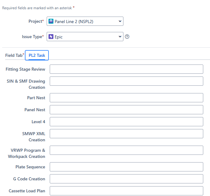

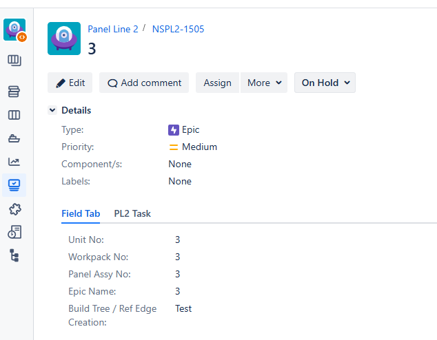

So I had plain text custom fields added to the EPIC with the names of each individual task. And I am attempting to write an automation for when a task transitions from one status to another the custom field on the epic relevant to that task would be updated with the appropriate text to identify the status.

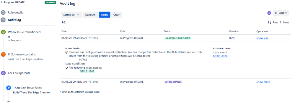

I am hoping with these being actual fields within the EPIC then it will now let me use those as columns on EazyBI (FYI: I have zero experience with eazybi). I just can't get this automation to run for whatever reason. For the separate automation in the screenshot in my first message called In Progress UPDATE, the audit log doesnt show an error when I transition the task. It only shows 'No Actions Performed'
This shows the field I attempted to update still showing as 'Test' (which I manually entered) as opposed to 'In Progress'.
