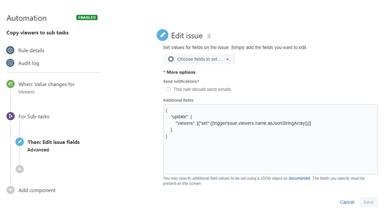

That's how I already did it:

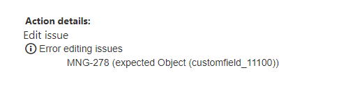

But it doesn't work. Log says:

A couple of things to try would be to add a Log action before you set the field to see what that call to asJsonStringArray is returning.
Next, perhaps try just set it directly (without the coversion to the array) if both Viewers fields are list fields.

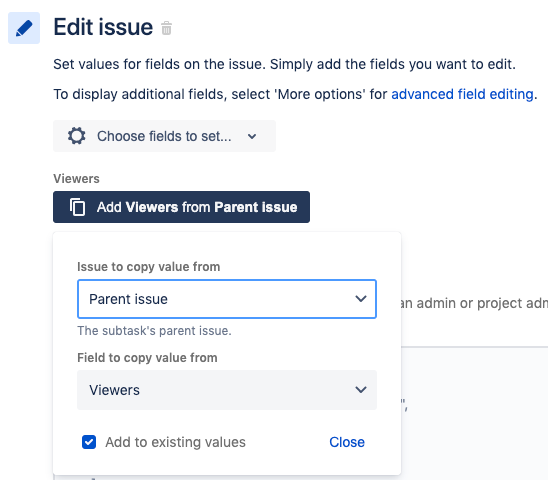

I agree with Bill, you should just try the built in function to copy value from Parent issue. It even has the option to "[x] Add to existing values" in case you don't want to overwrite any subtask viewers:

asJsonStringArray is returning list of users, for example:
triggerIssue.viewers.asJsonStringArray: ["testuser","samruk"]
I tried to set it directly:
"edit": {"viewers":"{{triggerIssue.viewers}}"}
And get an error in the log:
No fields or field values to edit for issues (could be due to some field values not existing in a given project)

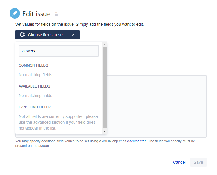

Hi @Darryl Lee  thanks for the advice. I can't choose field Viewers using Built-in function. That's why I use the Advice section. But I saw on your screen you could choose Viewers field, how did you do it?

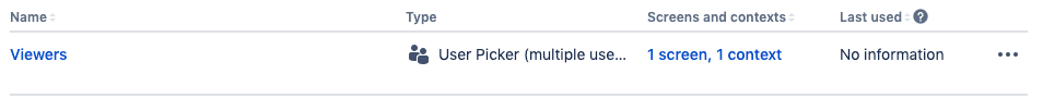

Here's what my Viewers custom field looks like:
Screen Shot 2021-01-11 at 9.12.39 AM.png Bill mentioned that you could talk to your instance admin to get the custom field name/number. Do you not have full global rights on this Jira instance, but just project? I wonder if that's the limitation you're running into.
