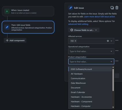

I have what is a very basic automation.
  • When: Issue created
  • Then: Edit issue fields
Thats it.
The fields in question are "Product Categorization" and "Operational Categorization."
  • Both are custom fields, but added from JSM when enabling ITSM features in the project.
  • Both are cascading select lists.
  • Both fields have a single context for all projects with only two drop-down choices: "Ask Jira Admin to customize" and "TBD" with no child options  (The default choices were deleted after the fields were created because they do not apply to us at all)

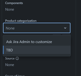

When I try and build my automation and chose the fields to set, I see them. They are added, but the options to select from the list are all the old ones I deleted.
It should just show "Ask Jira Admin to customize" or "TBD"
When I look at a ticket in this project - the fields are there, and the drop-down choices are correct.

I did get the automation to finally run using JSON and the fieldIDs.
I think you are correct about them being 'some type of system field.' It just acts weird!! - Since the fields came from JSM ISTM features, I am going to submit a bug.  I am pretty confident I did nothing wrong :)
