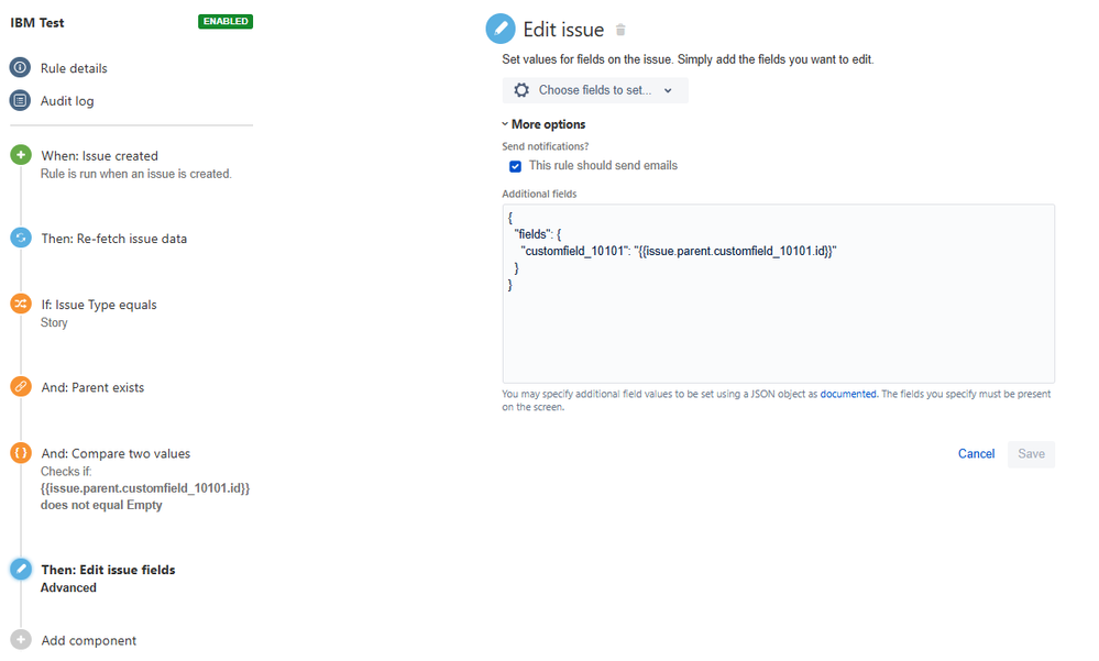

I have been trying to make this automation work for too many hours and need help! I know it can be done, but I am missing something. I found a bunch of examples, but none worked unfortunately!
Steps:
Sounds easy.. but I am STUCK!

First, your rule is branching to "Most recently created issue" but no issues are created during the rule; that is the purpose of that branch type. The branch may be removed.
Next, your rule is referencing what appears to be a Created Variable by it has not been defined anywhere.
Assuming your "Team" field is customfield_10101, please try this:
  "fields": {
    "customfield_10101": "{{issue.parent.customfield_10101.id}}"
Bill
Thanks! I was hoping you would respond!
Should I replace the team # with "id"
Still not working - used the straight code and tried to replace with team # (4379)

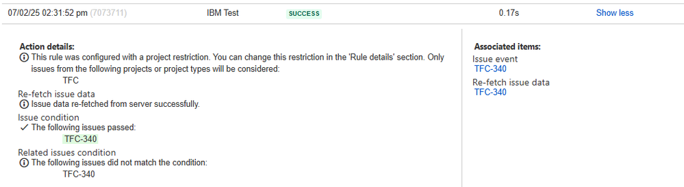

Please post an image showing the audit log details from trying to run the rule.
Also, have you confirmed that is the correct custom field ID for your field?
yes, customfield_10101 is correct.
I tested on 2 different projects - neither inherited the Epic's team name.
