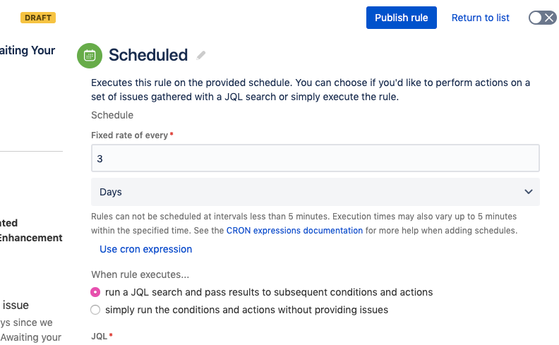

JQL: project in ("Test1","Test2") AND status = "Awaiting Customer Approval" AND updated < -3d
When I execute this job, it resets the last updated so I think if I keep running it, it will keep adding the same comment. I want to add a different comment on day 5 and then yet another differently worded comment on day 7 and auto close. Your help is much appreciated!

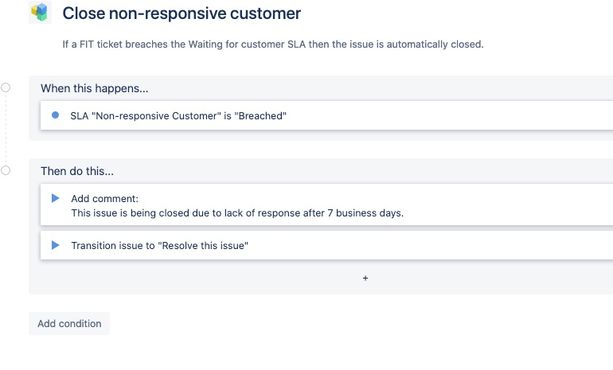

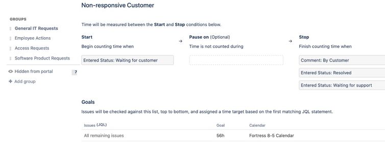

yep you can't use last updated for that reason. The way I handle this is with an SLA. I just responded to another very similar thread yesterday. I use standard Automation for this. Here is how....
SLA...
