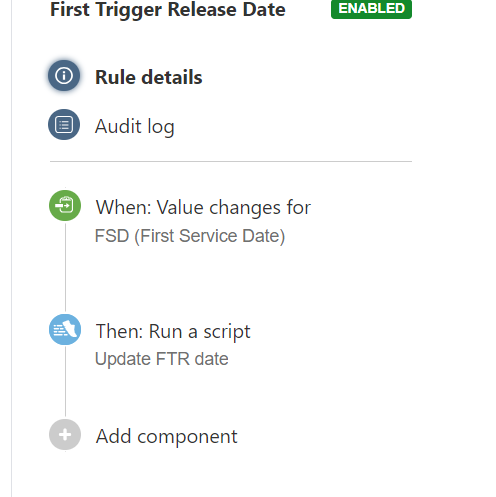

Hi Team,
I am trying to update a date field called "FTR" whenever another date field (FSD) is updated.
I am trying to do this using Automation for Jira (attached screenshot).
My script is as below

But it is not updating the FTR field.
Am i missing something here?
