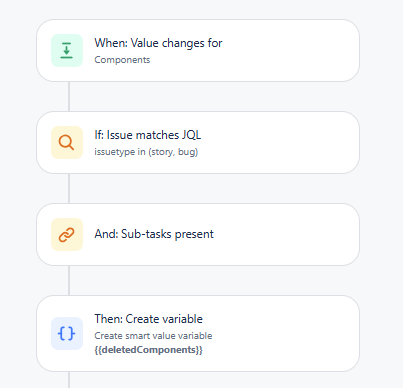

When a Component is removed from a Story / Bug I want to
Trigger: Value deleted for the Component field
If: JQL: issuetype in (bug, story)
If: Sub-task is present
Then: A variable, "deletedComponents", is created for the deleted Component(s), with smart value:
{{#changelog.component}}{{fromString}}{{/}} For: Linked Issues of correct link type
If: JQL: component = {{deletedComponents}}
Then: transition Issue

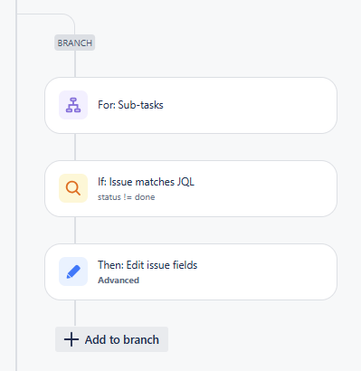

For: Sub-tasks
If: JQL: status != done
Then: Edit Issue, advanced editing:
"update":{
"components": [{
"remove": {"name": "{{deletedComponents}}"}

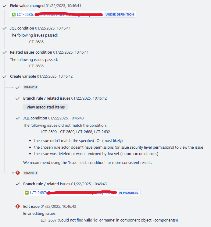

The setup works as expected if I remove a single Component from the Bug or Story, the problems start when I remove more than one Component:
So I printed {{deletedComponents}} and it turns out all removed Components are put together in a single string, e g comp1comp2comp3, which I guess explains why it works with a single Component but not more than that. comp1, comp2 and comp3 are existing Components and thus recognized but no component called comp1comp2comp3 exists.
