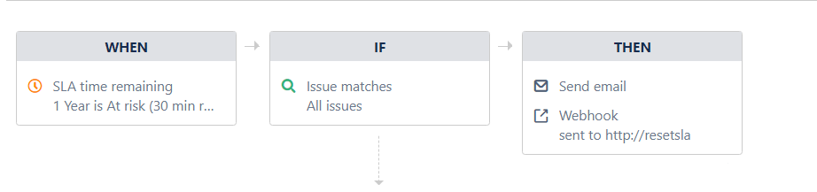

Here's my example, showing my automation (RuleSet) in JIRA Server.
My SLA timer expires after 1 year.  The email is sent and my webhook is called.  The webhook resets the SLA timer for another year.
The problem is that this automation needs to be reloaded into JIRA's queues as a RuleSet so that for year 2 the email needs to go out again & the webhook called again.  The automation is never called again after it is executed after the first yearScreenshot 2021-06-03 115302.png
