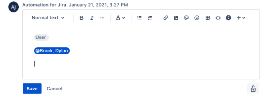

If you edit the comment and view it in Text mode, do you see anything wrong with the content? Maybe we can reverse engineer this and see what we can do about it.
Here you can see the difference. The "user" is what the automation creates, the blue bubble is my manual add for context and to see the difference.
I agree, I noticed assignee was not shown as possible, but because I have been able to identify the previous user (though only as plain text) I had hoped it was possible to jig together.

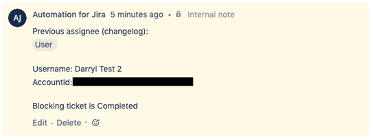

Hey Dylan - can you please send a screenshot of your rule? I've repeatedly been unable to get either the accountID or displayname of the Previous Assignee using any of the code you posted:
{{#changelog.assignee}}{{fromString}}{{/}}
OR
{{#changelog.assignee}}{{from}}{{/}}What I'm wondering is whether in fact, you're not actually getting that value at all.
The only way I was able to get the Previous assignee to show up in a Comment (or the log) was to add the Assignee field to the screen used in the Completed transition, and then change the assignee.
But at any rate, it looks like Automation is not properly interpreting Smart Values inside of the brackets, so the @ mention thing is not going to work regardless of whether we can figure out how to find Previous assignee for you.
Here's what I had in the rule to add a comment:
Previous assignee (changelog):
[~assignee.accountId:{{#changelog.assignee}}{{from}}{{/}}]
Username: {{#changelog.assignee}}{{fromString}}{{/}}
AccountId: {{#changelog.assignee}}{{from}}{{/}}
Blocking ticket is Completed
And here's the resulting comment:
