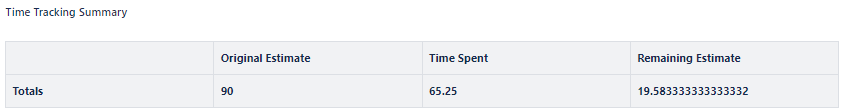

Currently the output looks like this.

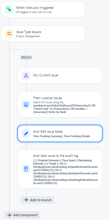

Here's the automation setup:

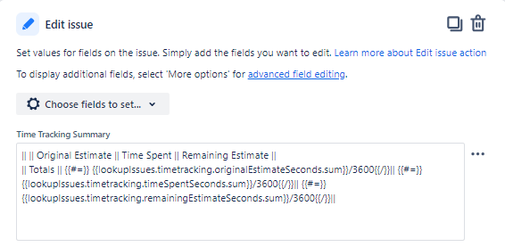

And here's the edit issue.
Here's the edit issue in text:
|| || Original Estimate || Time Spent || Remaining Estimate ||
|| Totals || {{#=}} {{lookupIssues.timetracking.originalEstimateSeconds.sum}}/3600{{/}}|| {{#=}} {{lookupIssues.timetracking.timeSpentSeconds.sum}}/3600{{/}}|| {{#=}}{{lookupIssues.timetracking.remainingEstimateSeconds.sum}}/3600{{/}}||
Don't mind the "||" characters here, these are used to format a table in the output to the multi-line text field in a wiki-renderer field configuration.

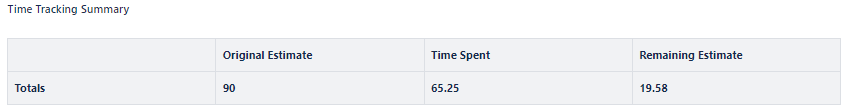

Then I found the solution using the ROUND function:
{{#=}} ROUND(({{lookupIssues.timetracking.originalEstimateSeconds.sum}}/3600),2){{/}}
{{#=}} ROUND(({{lookupIssues.timetracking.timeSpentSeconds.sum}}/3600),2){{/}}
{{#=}} ROUND(({{lookupIssues.timetracking.remainingEstimateSeconds.sum}}/3600),2){{/}}
This gave me what I wanted in the first option:
