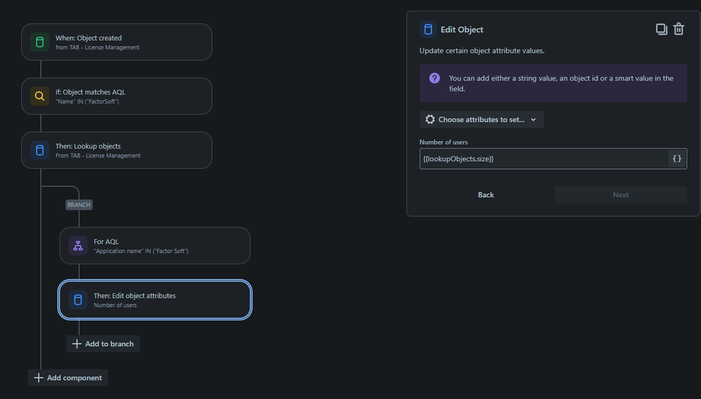

My thought process is create an automation rule that when an object is created in schema A, then object in schema B would be edited to change an attribute (in this case number of users) to show the number of objects in the object type from schema A.
Use case: We track our software by object type, each object is a license in that software tied to a user. So number of objects = number of users in that software. (Schema A)
We have another schema that tracks the software itself. We have information on the vendor, who admins the software, etc. (Schema B). I have added an attribute "Number of Users" to schema B and would like to show the number of objects in the corresponding object type from Schema A.
I provided a screenshot of my broken automation. Any info would be awesome! Thanks!!!
@Harrison Ponce
I figured out my issue! I needed to correct my look up objects step.
objectType = "your objectType"
Now when an object is created in one schema, within a certain object type. An attribute is updated showing the number of objects from that original schema in an entirely separate schema! However, now it is only showing 100 when I clearly have more than 100 objects within the schema. Suppose that is just a jira limitation though.
Could be! This is still a fun puzzle I'm trying to solve (because I like to torture myself like that lol)
I did see something about using ".size" at the end of lookupObjects to return a value. (See bottom of this page). I had wondered if something like lookupObjects.size would work if you had a really killer AQL for your lookup objects?

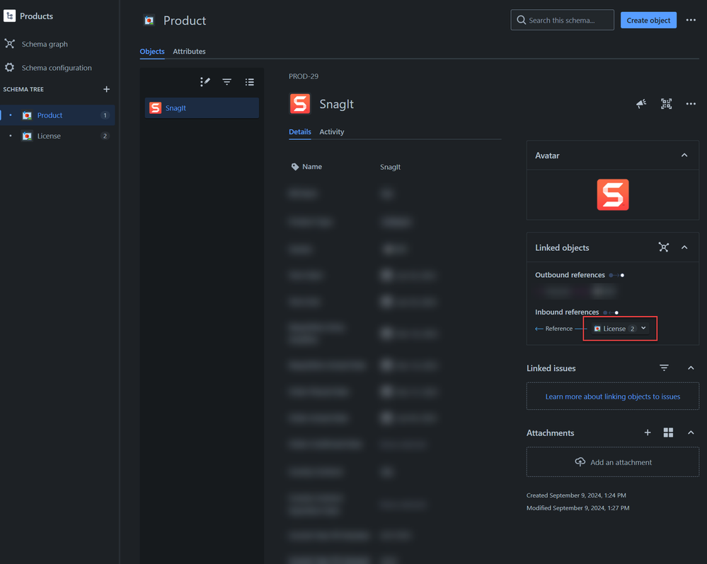

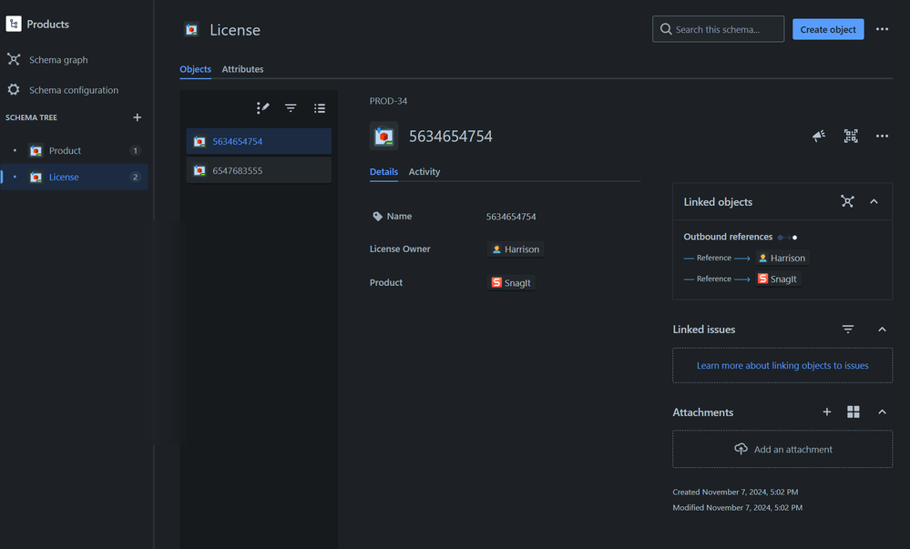

I have an alternative to suggest, which may or may not work for you. We do something similar where we have Software objects and License objects. The license object has an object type attribute that ties back to the software, so when you're adding a license, it lets you select which software it belongs to. Then on the software itself, looking at the object relationships, I can see the count pretty easily without having to do some backend automations all the time. Would something like the screenshots below work?
Hi @Harrison Ponce This does work! However my ultimate goal is to provide this info to people who will view it through a confluence page (since they do not have access to our schemas). So It would have to come up as a column. Thus my creation of the attribute. Thank you so much for your suggestion though.
