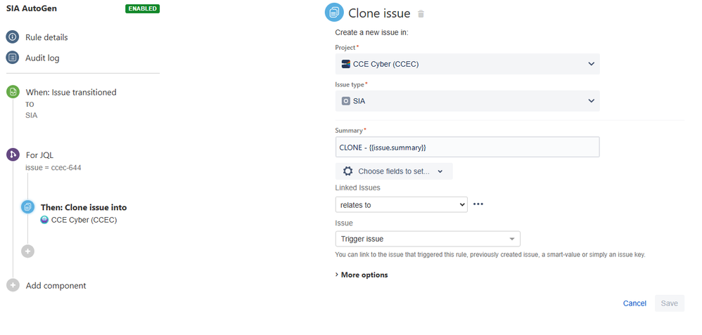

Here are the details. I have a primary project (NMPM) that is supposed to kick off activity in another project (CCEC). When my issue in NMPM is transitioned to the "SIA" status, I need it to clone CCEC-457 as a new ticket in the CCEC project and link it back to the NMPM project. Is this process possible using automation? If so how? So far this is what i have but i don't know how to specify that i want it to clone CCEC-457.
Ok so the solution was actually very simple. Do it from the global automation level. Use a branch and clone from there.

Hi Scott,
Try to change Then: Create a New with Then: Clone issue into
Also you will need to specify the issue type and what field you want to clone in the new issue.
Hope this helps.
hey @Cristian0791 yes sorry i switched to create to test something but it didnt matter. I switched back to clone but the problem is you can define specifically what ticket you want to clone. only the project you want to clone.
