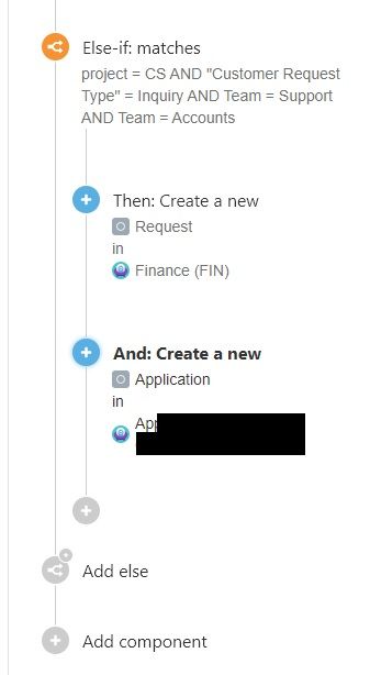

Shah Baloch
June 30, 2021
Hi, I installed Automation for Jira. I also created a checkbox custom field with options "Support", "Sales", "Accounts", and "Other". I configured to create a link issue to Support project if support is selected, created linked issue in Sales project if "Sales" is selected. That part is working fine. However, I want it to create multiple link issues if multiple options are selected, suppose Support and Accounts, a link issue should be created in Support and another in Accounts. But it is not creating multiple issues, it'll create one issue in the first project that added in the "Then" condition.
Here is my JQL
project = CS AND "Customer Request Type" = Inquiry AND Team = Support AND Team = Accounts
Isn't possible to create multiple issue base on the option selected from custom check box field? Or am I do anything wrong?
Thank you for your help.
