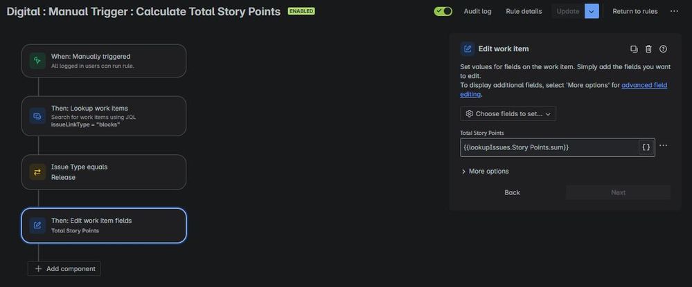

Step 3: (This is what is not working) Sum of Story Points from Related Work Items using {{lookupIssues.Story Points.sum}}.

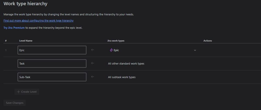

I have not edited anything specific in the work Hierarchy and the scheme is as below:
Epic : 1
All others like Task, Story, Release, Improvement, Bug : 0
Dev Sub Task and QA Sub Task : -1

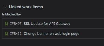

I am linking (blocks) with the Release (this is also a task type with a specific workflow for release management) as below
Here
IFB-184 is the release. This release (IFB-184) has IFB-97 and IFB-22 as the stories. IFB-188 is the Dev-Sub-Task in the IFB-22 Story.

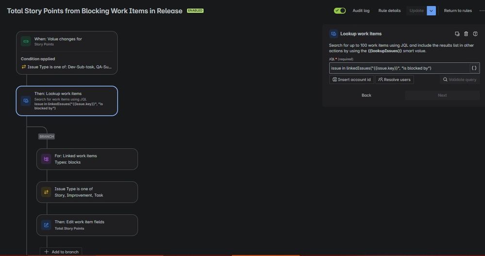

Here is the screenshot of the Automation which is not working.

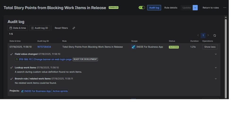

Here is the Screenshot for Audit Log:

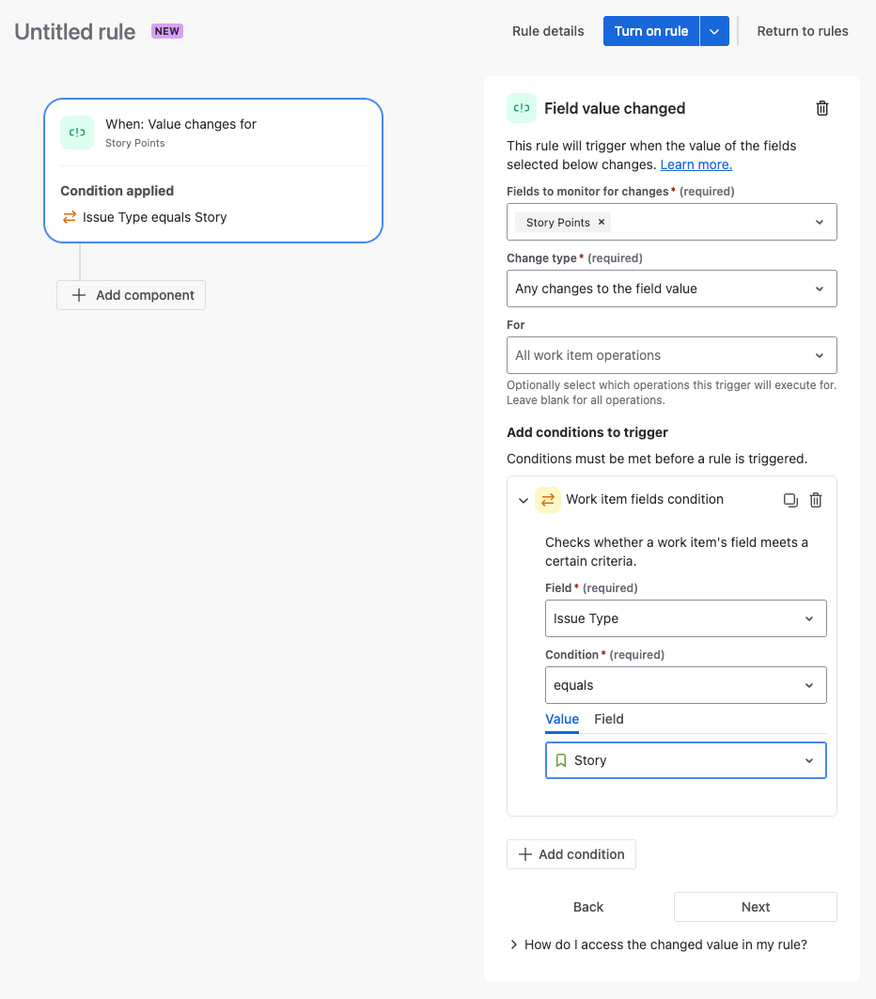

For the very simple case where the points on a Story has changed and you want to update the total points on any linked Release issue type:
Use the Field Value Changed trigger to detect a change in the field. Add a condition to it to confirm the change was in an issue type of interest (Story).

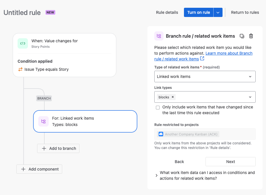

Add a branch to change the focus of the rule to any issues linked to the trigger issue, where the trigger issue "blocks" the linked issue.
The actions nested under the branch will be applied to each issue found by the branch.

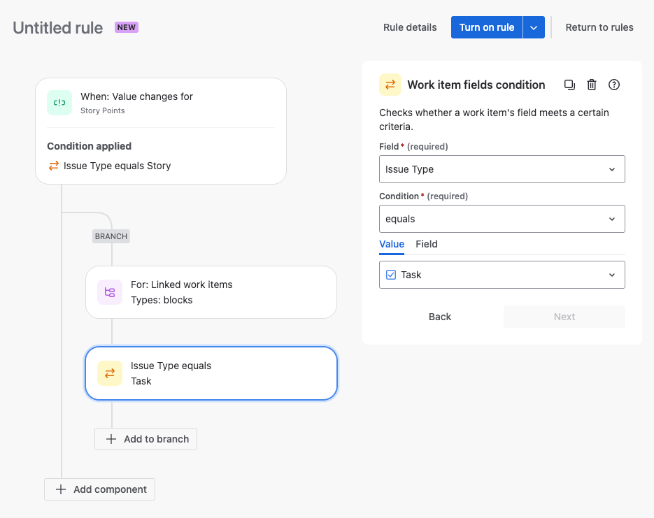

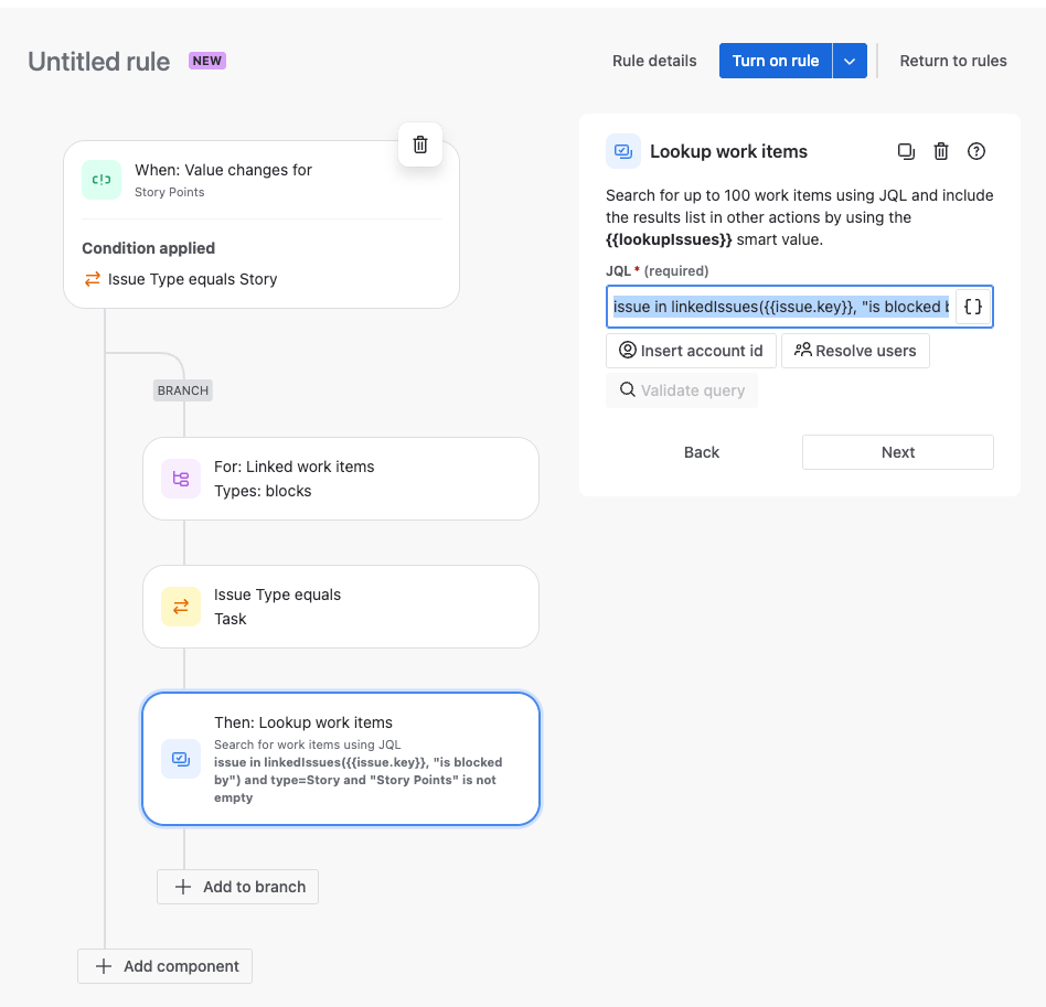

Add a condition to check that the linked issue found is of the issue type that you want to update (Release) [I'm using Task in my example]
Add a Lookup Issues action to lookup all the Stories that are linked to the Release issue that is currently in focus in the branch.
The JQL I used for this is looking for all the Story type issues where Story Points is not empty and the Story is linked to the Release with the "is blocked by" link.
issue in linkedIssues({{issue.key}}, "is blocked by") and type=Story and "Story Points" is not empty

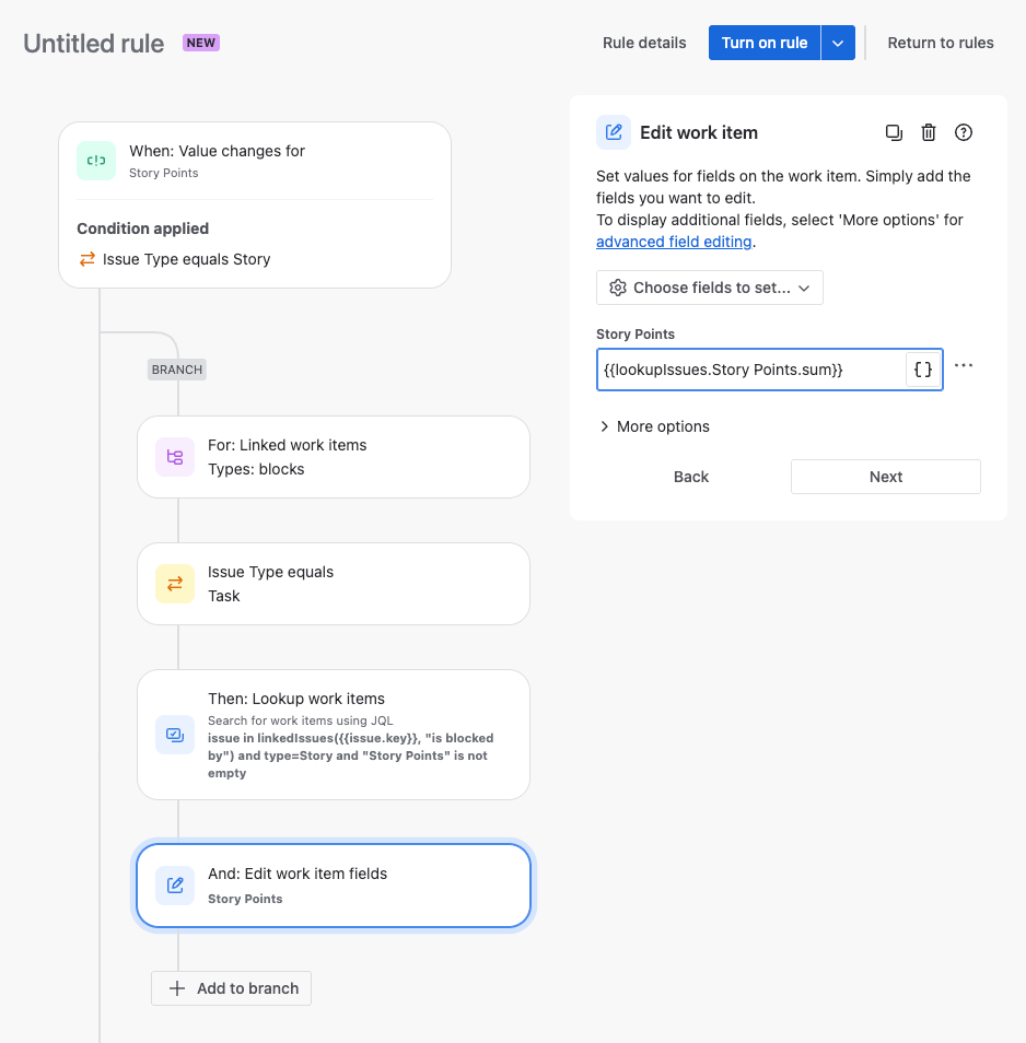

Then use an Edit action to set the value of the field in the Release issue as the sum of the Story Points fields in the issues (Stories) found by the Lookup. In my example I am putting the sum into the Story Points field in the linked Task.

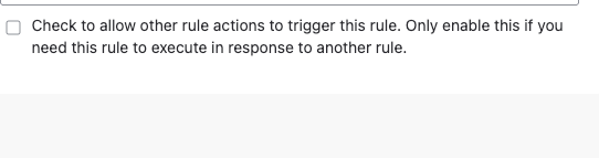

In addition, because the Story itself may be updated by another rule (the rule that sums Subtask points up to the parent Story) you will need to check this box on the Rule Details page:
There are several reasons why your rule did not update the Story, looking at the Audit Log you provided.
The rule was triggered by a change to issue IF-188, which you said that IF-188 is the subtask issue.
You are then doing a Lookup of issue linked to the trigger issue. I'm not sure why you're doing a Lookup at this point, but since the trigger issue was the subtask, this lookup will not find any linked issues.
Next you are using a branch to change the focus to issues that are linked to the trigger issue by "blocks". Since there are no issues linked to the trigger issue (subtask) by "blocks", this branch finds no issues and does nothing.
You said you have a rule that successfully updates a Story based on changes to the Subtask. Am I correct that is a different rule than the one you have shown?
If so, then the rule you showed would at least need the checkbox checked as I mentioned above, so that the rule to update the linked Releases could be triggered by the rule that updated the Story.
