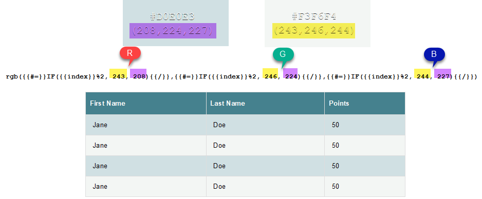

So after a bunch of Red Bull I came up with a work around using the RGB method... So if you are looking to have alternating row colors in your table, simply add the following to your <tr> tag:
<tr style="background-color: rgb({{#=}}IF({{index}}%2, 243, 208){{/}},{{#=}}IF({{index}}%2, 246, 224){{/}},{{#=}}IF({{index}}%2, 244, 227){{/}});">
Explanation:
Thanks, Dan! That's great!
I did not know the modulo operator could be used in a stand-alone condition. Must be the math operation wrapper that allows that, and it certainly opens up possibilities for the other operators.
