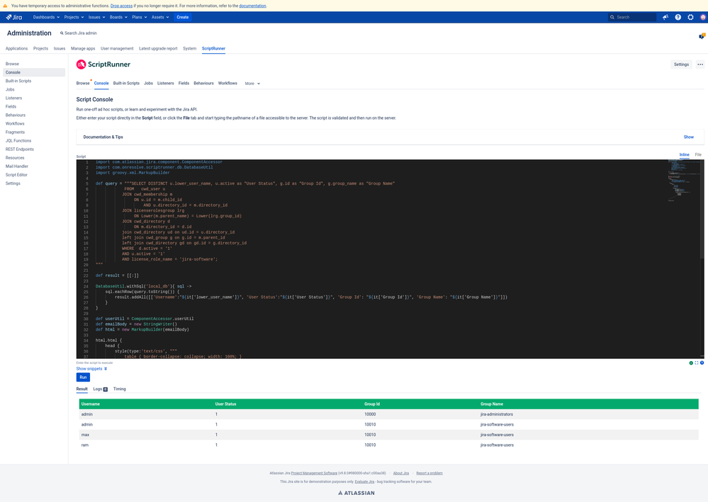

Please note that the sample working code above is not 100% exact to your requirement. Hence, you will need to modify it accordingly.
Below is a screenshot of the code executed on the ScriptRunner console:-
I hope this helps to solve your question. :-)
