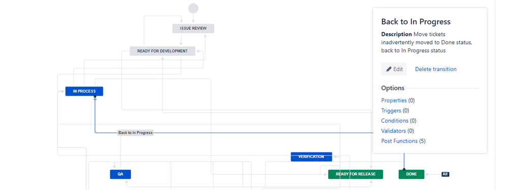

I am not able to open/move a ticket back since the resolution is marked as duplicate.
How could I change the workflow to give me an option to move this ticket back to in progress ?
Is there a condition or a post function that needs to be added in order to work ?
Thank you
Marek Soukup
September 23, 2020
Don't you have any property set on Done status?
Jack Brickey
September 23, 2020
so when you try to execute the "Back to In Progress" what happens? I don't see any Conditions listed so on the surface it seems it should work. More info might help me diagnose the cause.
Joao Borges
September 23, 2020
I was able to move back to In Progress. But i would like to remove the resolution = duplicate
Marek Soukup
September 23, 2020
You can use post-function "Update issue field" and select Resolution issue field and change the value to none.
Joao Borges
September 23, 2020
But where should i add this post-function ? Ticket marked as Done or back to in progress section ?
Joao Borges
September 23, 2020
@czsup  it worked. Thank you
