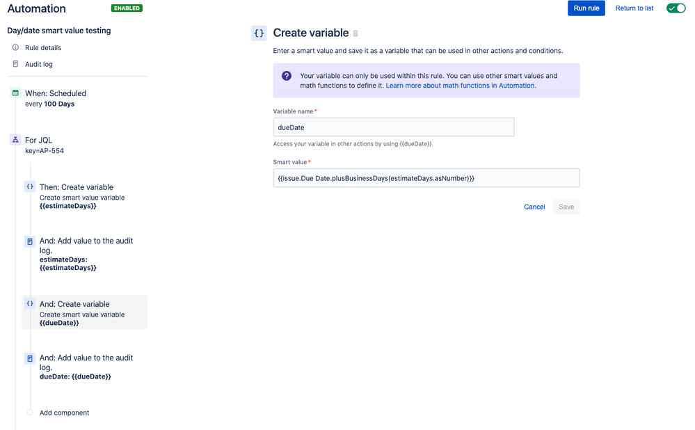

Hi @Diogo Teles, what you're trying to do is possible. There are just a few additional things to recognize about smart values before it'll work.
Here is the solution that you're looking for, I'll explain it below.
Two things:
1. Once you're insight of the handlebar syntax `{{`, you don't need to use it again to reference variables.
2. The create variable action stores the variable as a string, so one needs to use the asNumber function to coerce it into a type appropriate for use inside plugBusinessDays.
Hope that helps. :)
