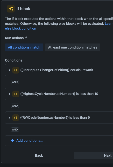

it seems jira changed something; nevertheless here is my scenario and solution to it.
my requirement was a jira issue with title t should be able to automate with a change request or reword and marked in a new ticket t+1 with CR02-000 (first digits) or rework RW01-001 (last three digits) increase +1
therefore from t to t+1 its easy you know its the second ticket so either its CR +1 = 2 or its RW therefore 01 stays and the sum of 000 + 1 = 001.
The magic starts with reading from ticket t how many linked tickets t+x exists; read the last and calculate based on the logic + 1.
I found out that I can do things like this:
(easy)
var: HighestCycleNumber =  {{lookupIssues.summary.match("^(?:CR|RW)(\\d+)-").asNumber.max}}
(advanced - a two step process!)
var: TempRWCycleNumber = {{lookupIssues.summary.match("^(?:CR|RW)(\\d{2}-\\d{3})").replace("-", "").asNumber.max}}
var: RWCycleNumber = {{TempRWCycleNumber.right(3)}}
and than some if else explosion (yes I used pen and paper to get my scenarios)
When creating than the new ticket the title is in this first example:
RW0{{HighestCycleNumber}}-00{{RWCycleNumber.asNumber.plus(1)}} : {{triggerIssue.summary}}
Why so complex?
Easy, when using regex Jira does not allow to keep leading 0's...
Therefore I had to identify the amount of leading 0's and made it work.
hope that helps; it took me a while and AI could not figure that out either :P
