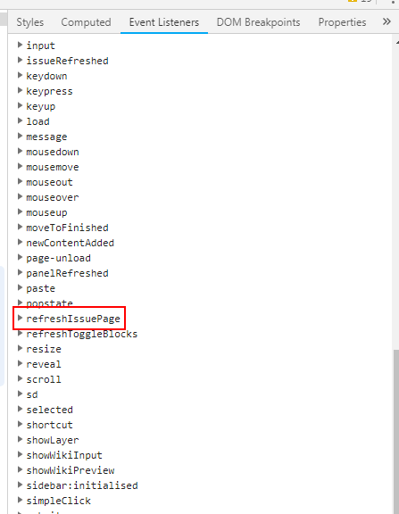

I'm looking for very specific need. I'm developping a userscript to send notification througth dedicated API (https://developer.mozilla.org/fr/docs/Web/API/notification).
My script works but if I'm not on the page, on the browser (Google Chrome), the refresh of the current queues is stopped.
I create new issue and then I tried to replay xhr queries but nothing is refresh.
I tried to send event "refreshIssuePage" and some others customed events, but nothing happens.
var evt = new Event('refreshIssuePage');
document.dispatchEvent(evt);
Is someone know how to refresh the current queue of selected prohect when JIRA runs in background ?

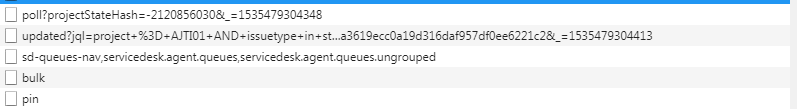

Each time I come back on page, the "poll" request is sent :
I didn't found Web Worker/SSE which could manage refreh of current queue .
Maybe there is a flag which tells the page have not the focus and stops the refresh (in DOM element 'window' (probably window.AJS) or 'document' ?
All help is welcome.
Best regards,
Nicolas DUPRE.
