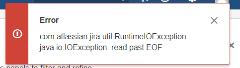

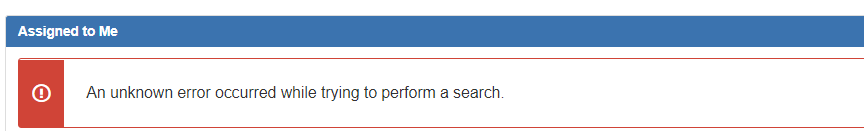

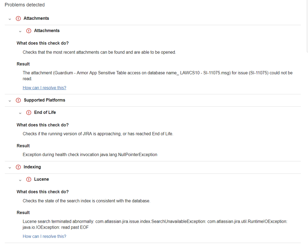

Hi Team,
I got an erros in jira like as shown in the screen shorts app.PNGerrrrrr.PNGapp1.PNG
can any one help me out please its urgent.

You have a string of rather worrying errors there.
  • The attachment error implies something wrong with either the file system or attachments area of the database
  • The end of life warning means either you have an out-of-date Jira, or that it cannot reach the internet to check (this one, don't worry about for now)
  • The indexing error suggests a damaged index
  • The Java IO error suggest a problem reading another file somewhere
I would start with a look at these:
  • What type of database are you using?
  • Are you out of disk space on the server?
  • Less urgently, are the permissions correct on the Jira installation and home directories?

Ok, great on the database, it means it's almost certainly not a database problem.
For the space and permissions, you will need to log into the server and look at the disks.  How you do that is up to the OS and what access you have to it.

Hi @Nic Brough -Adaptavist- I have deleted the INDEXES directorie form Chache folder from server so now everything working fine.
Now only log analyzer is not analyzing and the ticket that are created form 1pm to 4pm for those tickets the work flow transition buttons not showing.
could you suggest me how to resolve this

Not sure why you did that when I've never mentioned it, but that does explain why all sorts of things are missing - Jira needed those files, and you've destroyed them.
To fix that, go to Admin -> Indexing, and run a full, locking index.
If the underlying problem you have is disk space, this is going to go wrong as it refills the disk, but you're going to have to do it no matter what.

Yes, it sounds like you still have damaged indices.  You'll need to establish what was happening that broke it before, and then you can establish what to do to fix it all.
Please, don't just randomly pick another possible problem and attempt another potentially pointless fix before you've looked into this properly.
Now you've tried to rebuild the index, do you have enough disk space left?  What errors are you still getting?
