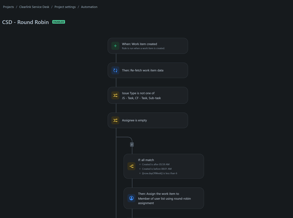

Hi @Ty Foster -- Welcome to the Atlassian Community!
The rule(s) you show are triggered on Work Item Created, and that trigger (and others) can have intermittent timing problems.  The challenge is the rule can start running before all data is available and the work item is in a stable state.  As your rule worked in the past, it is possible some data is not consistently available for the condition tests.
The mitigation for this is to always add the Re-fetch Work Item Data action immediately after that specific trigger.  This will slow the rule slightly, reloading the data before the remaining steps process.  Perhaps try adding that to see how the behavior is impacted.

Hey Bill,
Thanks so much for the tip!  Does this appear to now be set up in the way it should be based on your understanding?  Apologies for what may be a simple question here as I'm very new to managing Jira automations.
Like Bill Sheboy likes this
Bill Sheboy
May 5, 2025
Yes, that is correct.  Please test to learn if that helps the conditions pass when expected.

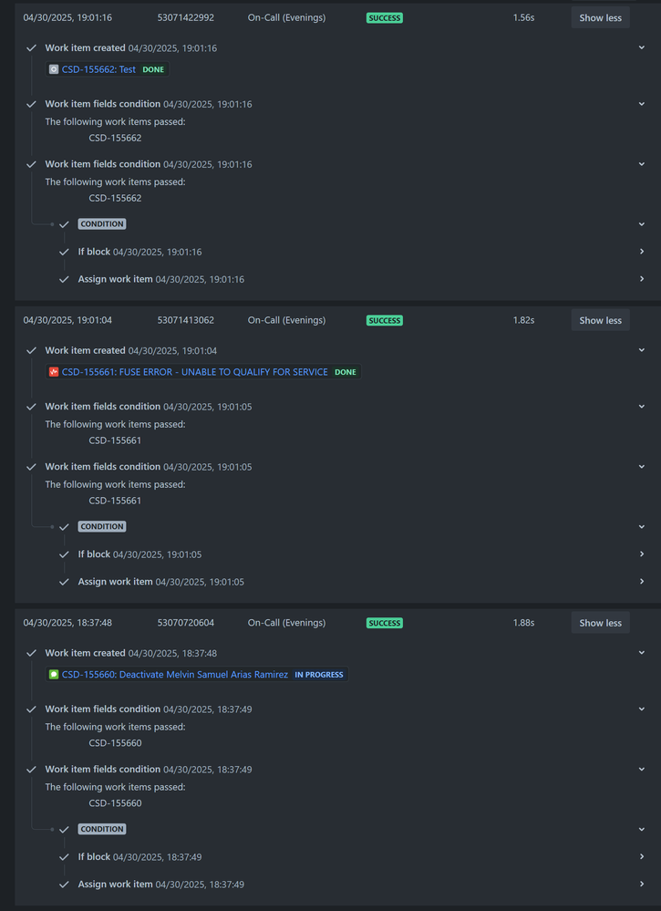

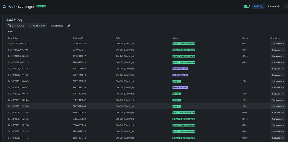

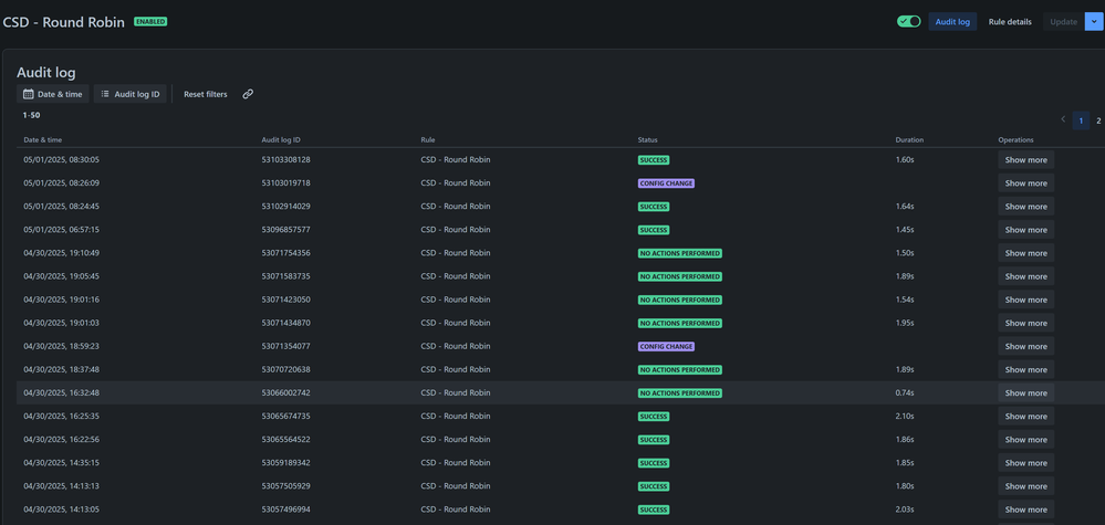

Ty Foster
May 1, 2025
The highlighted row is where the issue began.  The on-call rule should not be touching this issue, but it is.  Additionally, the round robin rule should be assigning it during this time frame, but it's not.

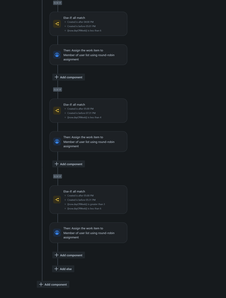

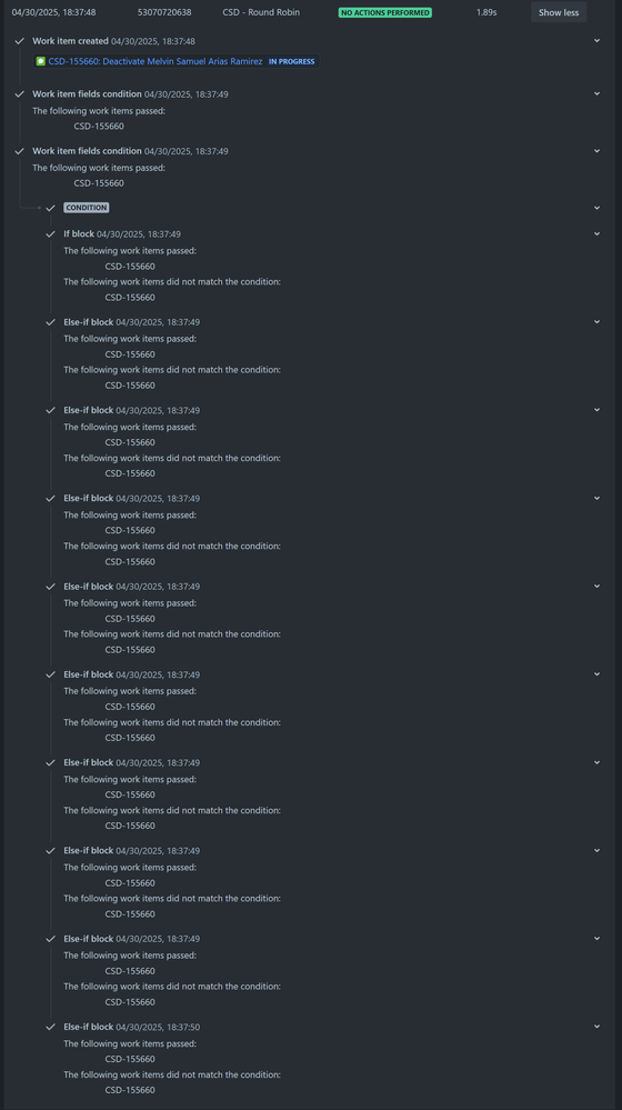

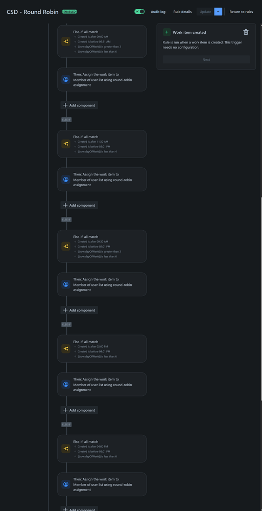

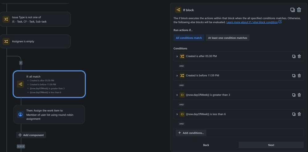

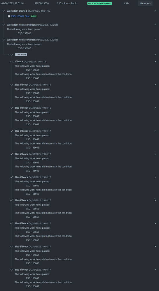

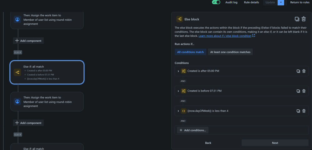

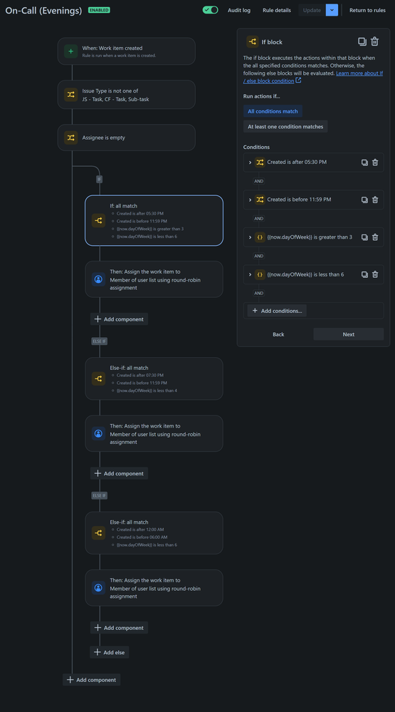

Ty Foster
May 5, 2025
Screenshot 2025-05-05 111859.pngScreenshot 2025-05-05 111823.pngScreenshot 2025-05-05 111553.pngScreenshot 2025-05-05 111421.pngScreenshot 2025-05-05 111232.pngScreenshot 2025-05-05 091929.pngScreenshot 2025-05-05 091909.pngScreenshot 2025-05-05 091813.png
Please see the attached photos of the full rules and expanded audit logs. Let me know if you need any other information.
Please note that for the "if block" for the on-call rule that is linked in the logs is the one shown in the screenshot.
