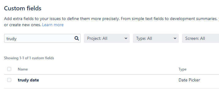

I have done my own test on Jira DC 9.4.11. For me the function works correctly when I use it with a custom field of type Date Picker
Perhaps there is a typo within your rule. Perhaps the field is not the Date Picker field type.
