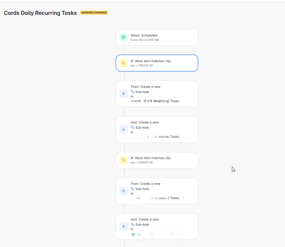

I'm trying to set up a daily automation that creates subtasks under multiple parent issues, but the rule stops after processing the first parent task. Here's what I'm trying to achieve:
Current Setup (not working properly):
When: Scheduled daily at 9:00 AM If: Issue key = FIB0PT-94 Then: Create 2 subtasks If: Issue key = FIB0PT-96 Then: Create 2 subtasks

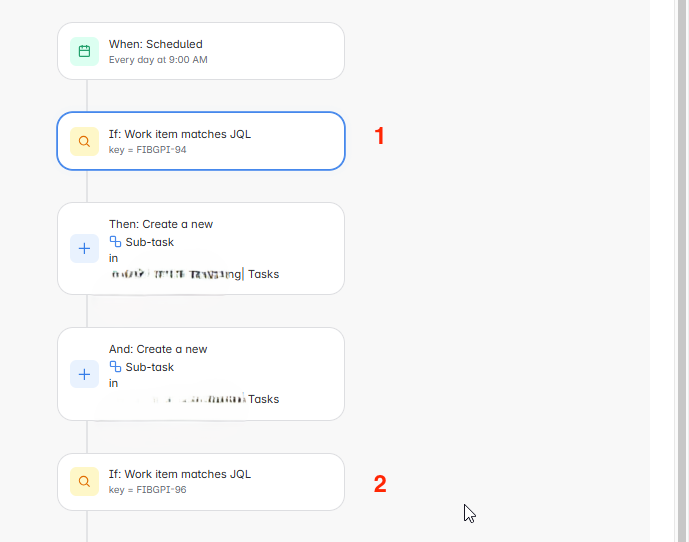

Hello @Mohammed_Zeyad
When you use a simple IF condition the rule will stop running with the first IF condition that does not pass.
If the issue key matches Condition 1 then the Create components immediately following 1 will be executed. When the IF condition at Condition 2 is evaluated, it will fail because the issue key does not match, and the current loop of the Scheduled rule will stop running.
If the issue key does not match Condition 1 then the current loop of the Scheduled rule will stop running immediately.
You will never get a loop of the Scheduled rule that will match conditions 2..n because the rule cannot match both Condition 1 and any subsequent condition.

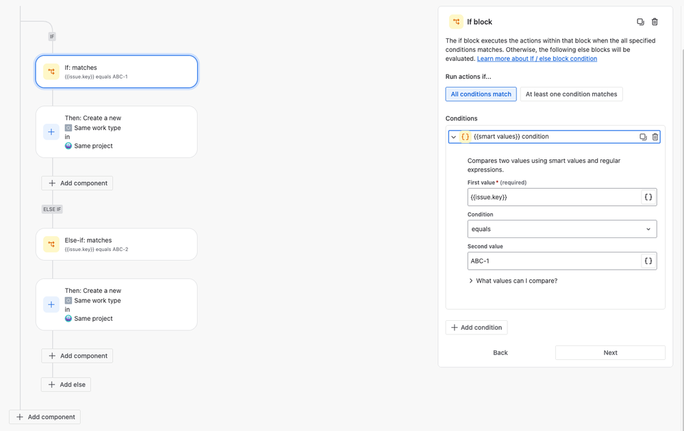

If the Subtasks need to be different for each parent then you need to use the IF/ELSE condition.
With If/Else the rule checks if the first condition passes. If it does then it executes the components directly below that condition. The rule then skips all the Else If conditions and proceeds with the steps that follow that block.
If the first condition doesn't pass, then the rule check the second condition (the Else If). If that condition passes, then the steps following it are executed, and the rest of the Else If conditions are skipped, and the rule proceeds with the steps that follow after the If/Else block.

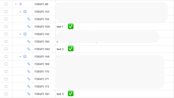

Unfortunately, my case is a bit different from the two examples you mentioned. The reason I used standalone IFs is because I approached it from a sequential programming mindset.
Let me clarify:
I have a project with an epic that contains 9 tasks. Each of these 9 tasks has 2 to 4 distinct recurring subtasks that need to be created daily — meaning I don’t want to skip any of them.
What I’m aiming for is something like this:
Task 1
Subtask A
Subtask B
Task 2
Subtask C
Subtask D
Task 3
Subtask E
Subtask F
…and so on, up to the ninth task.
What I need is a way to automate this structure so that these subtasks are recreated every day under the right parent tasks. Any suggestions or workarounds that could help achieve this?

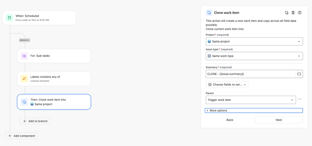

There are other ways to accomplish this with Automation. For example
- In each of the 9 tasks create a copy of each of the subtasks that needs to be created daily and add a label to it like "subtask-template"
- Create a rule with a Scheduled trigger and a JQL to select the 9 tasks.
- Add a Branch - For Each Sub-task
-- Condition: If Labels contains-any-of subtask-template
-- Clone Issue

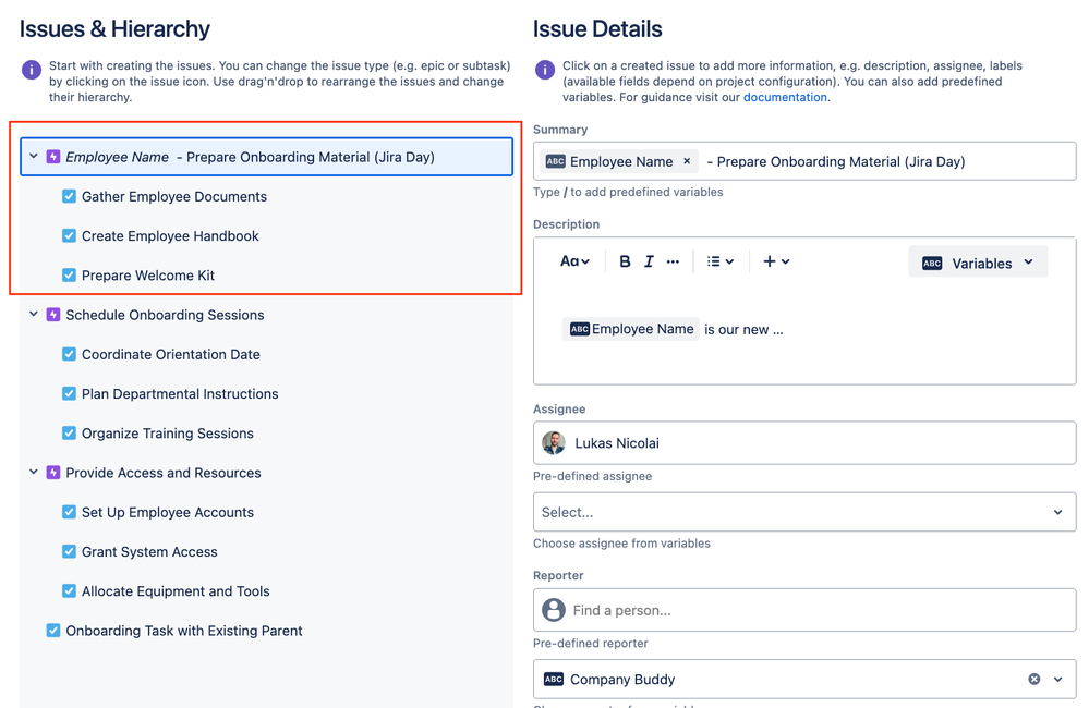

Hey @Mohammed_ZeyadIf you have 9 tasks with distinct recurring subtasks that need to be created daily, I think Templating.app could also be a good alternative for you.
You can find us at the Atlassian Marketplace ➡️ https://marketplace.atlassian.com/apps/1224664
This is how this might look like:

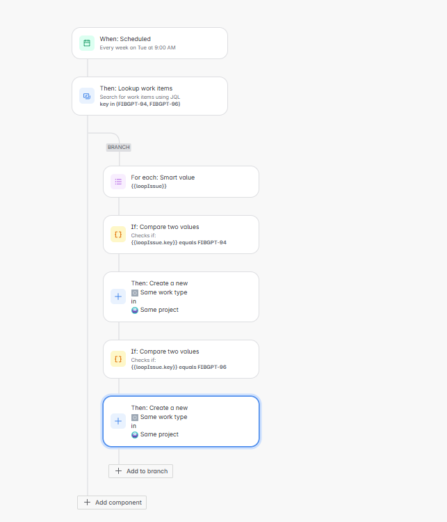

Try to add a “For each issue” Branch:
After the trigger, add a "For each: Issue" action.
Inside the branch, use the If/Else condition.
Scheduled Trigger (JQL: key in (...))
|---> For each issue:
|---> If issue = FIBGPT-94
| |---> Sub-task A
| |---> Sub-task B
|---> If issue = FIBGPT-96
|---> Sub-task C
|---> Sub-task D

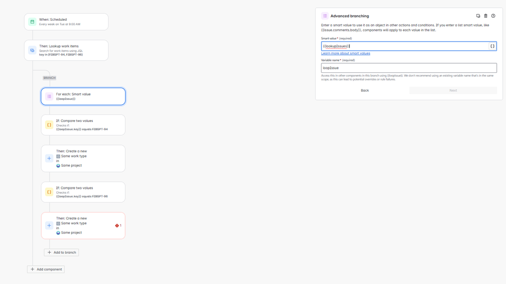

Hi @Mohammed_Zeyad
Thanks for the answer.

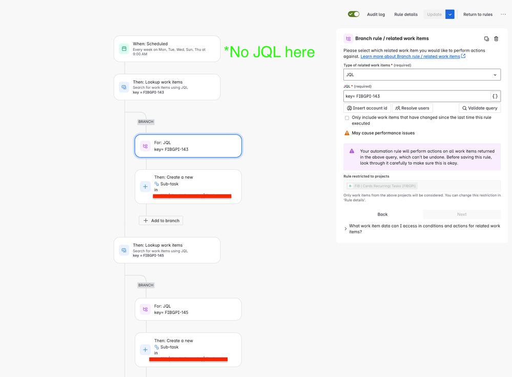

Please try this solution.The second image is the For Each branch comparison, what to write there.
Have you tested that yourself with issues that should match a condition beyond the first one?
I have. It doesn't work. Please see my answer explaining why it doesn't work.
