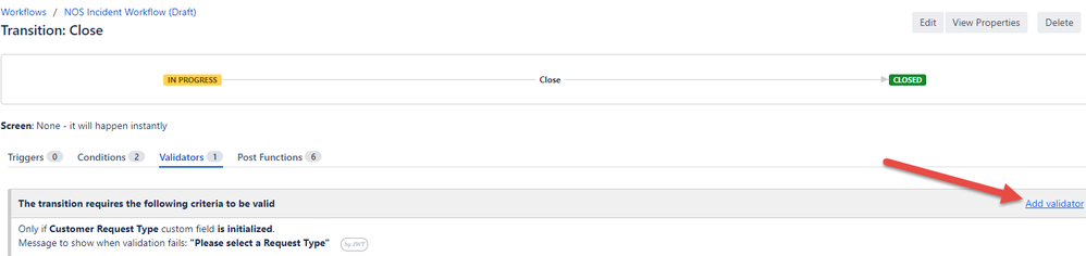

HI @Christian Fabila Here are the 3 Options that I have in "Validators".
| Permission Validator | Validates that the user has a permission. | |
| Script Validator [ScriptRunner] | Runs a script to check validation, or a built-in script. | |
| User Permission Validator | Validates that the user has a permission, where the OSWorkflow variable holding the username is configurable. Obsolete. |

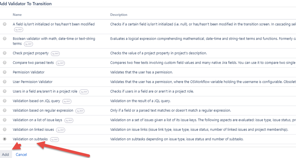

Hi @Christian Fabila If you have "Jira Workflow Toolbox" Add-on as @Raynard Rhodes suggested above using Validations it will work i have not tried that.
Kumar

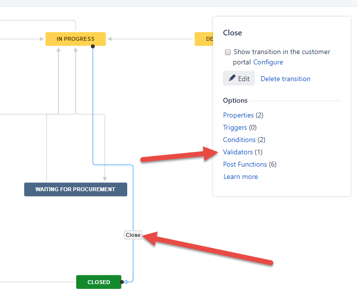

If you follow those screenshots (assuming you have Jira Workflow Toolbox) you will be able to set the conditions that need to be met.
You can choose the status or resolution the subtask need to be in for the parent issue to transition. You can even filter it based on the value of a [custom] field. Give it a try and see what happens.

Ah, o.k. You want to use a Validator instead of Condition. Conditions will hide the button with no indication of what needs to happen before it can be shown. Validators will pop-up a message with the default dialogue then the dialogue you choose.

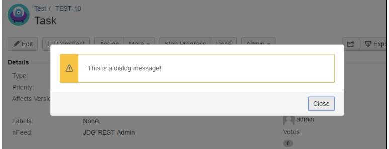

Hi @Raynard Rhodes Thanks for your reply
So, Here the condition has to work and instead hiding the button when any user click the "Close" button if the sub-task is still open a pop-up dialog box has to appear .
like this
The parent ticket has to stay in that status only.
Can you please help me how to achieve this.
Kumar
