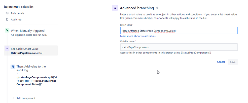

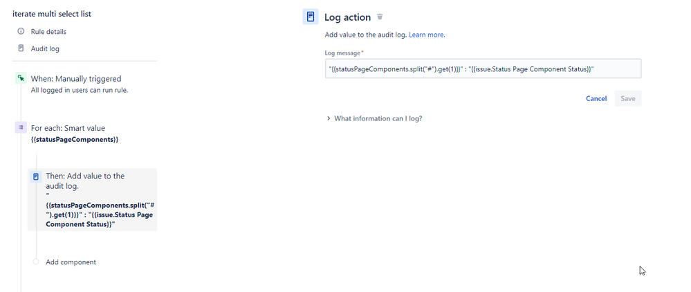

assuming I got your requirement right you´d like to iterate over the multi-select field and for each value in there write that value and add the value of the other single select field. Please correct me if I´m wrong.
If this is the case I tried solve this with a for each branch (see screenshot):
I hope this is helpful to solve your problem.

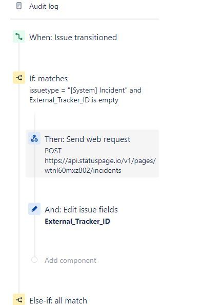

Please also provide a screenshot of your whole automation rule? This eould be very helpful (for me as well as for other answerers) to understand the whole context.
Best
Stefan
Below is what the web request looks like in the intended flow.
It is triggered like so...
In order to use branching, I would have to branch, save the results of each of the branches somewhere, then concatenate them back together when creating the web request.
The thread safety of branching is in question.
Because if I made a branch that...
Then if it's not thread safe, the string may get grabbed between steps 2 and 3 by another thread.
This would result in incorrect results in said custom field before all branches resolve.
