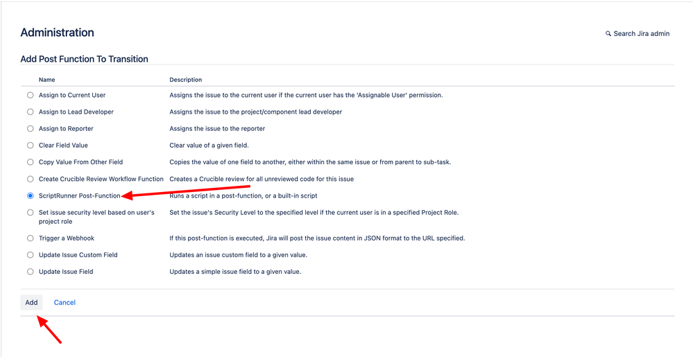

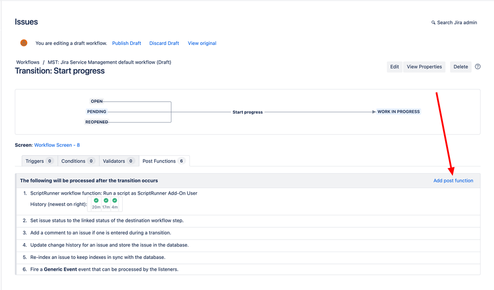

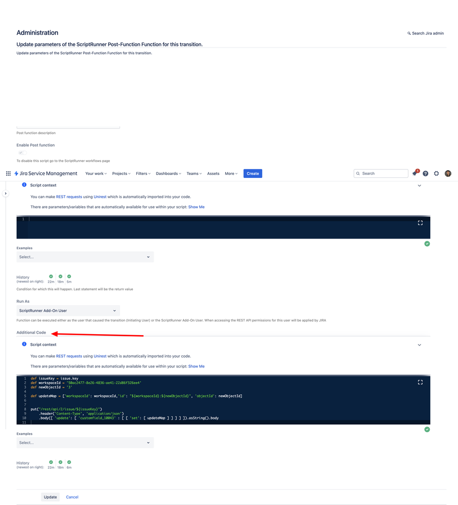

1. First, Add a post function as shown in the screenshot below:-
2. From the options provided, select ScriptRunner Post-Function as shown in the screenshot below:-
3. Next, select the Run Script option as shown in the screenshot below:-config3.png
4. Once you are on the Run Script page, add the sample script template to the Additional Code section, as shown in the screenshot below:-config4.png
Once you have modified the code accordingly, update it and publish your changes.

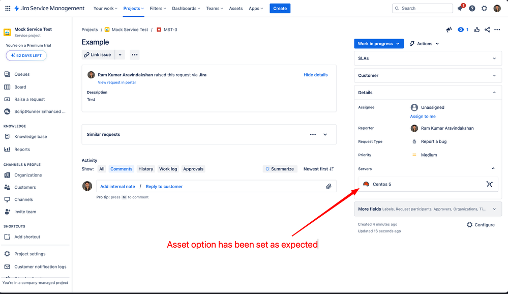

I am also including a couple of test screenshots for your reference:-

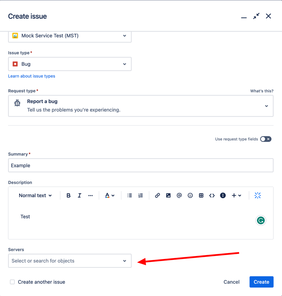

1. Create an issue if you don't have an issue already created. Don't set any value for the Assets field as shown in the screenshot below:-

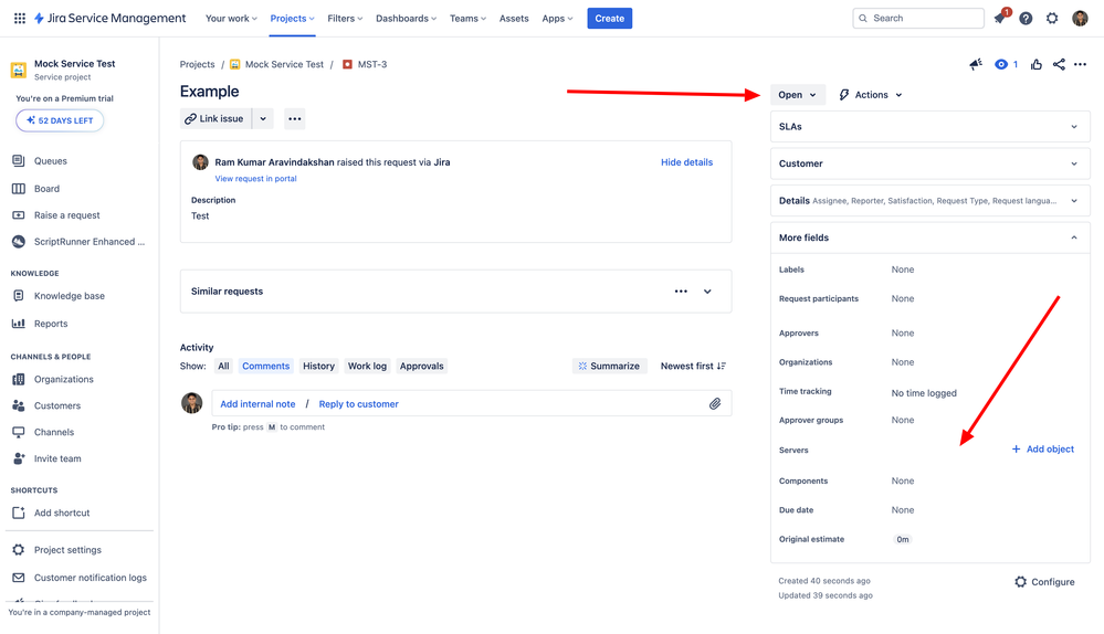

2. Once the issue is created, the Assets field is displayed in the More Fields section, as shown in the screenshot below:-test2.png

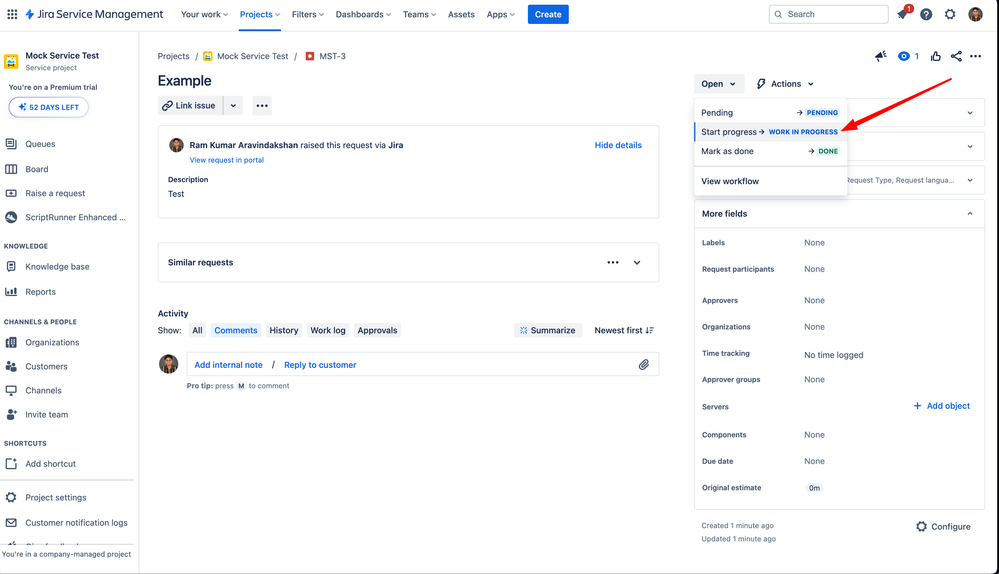

3. Next, transition the issue to the Status in which Post-Function is added. The Post-Function has been added to the Start Progress transition in this example. test3.png

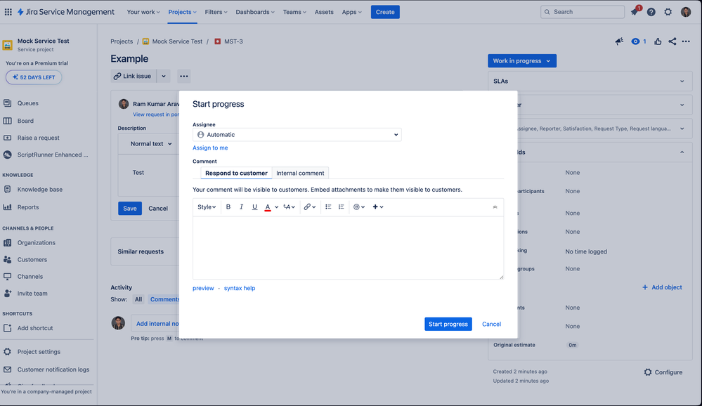

4. If there is any transition screen, set the values accordingly. The screenshot below includes only the Assignee and  Comment fields in the transition screen.test4.png
5. Once the issue has transitioned, the Asset field is updated accordingly and is moved to the Details section as shown in the screenshot below.  test5.png
Note: You may need to refresh your page once or twice to see the Asset field update take effect.
