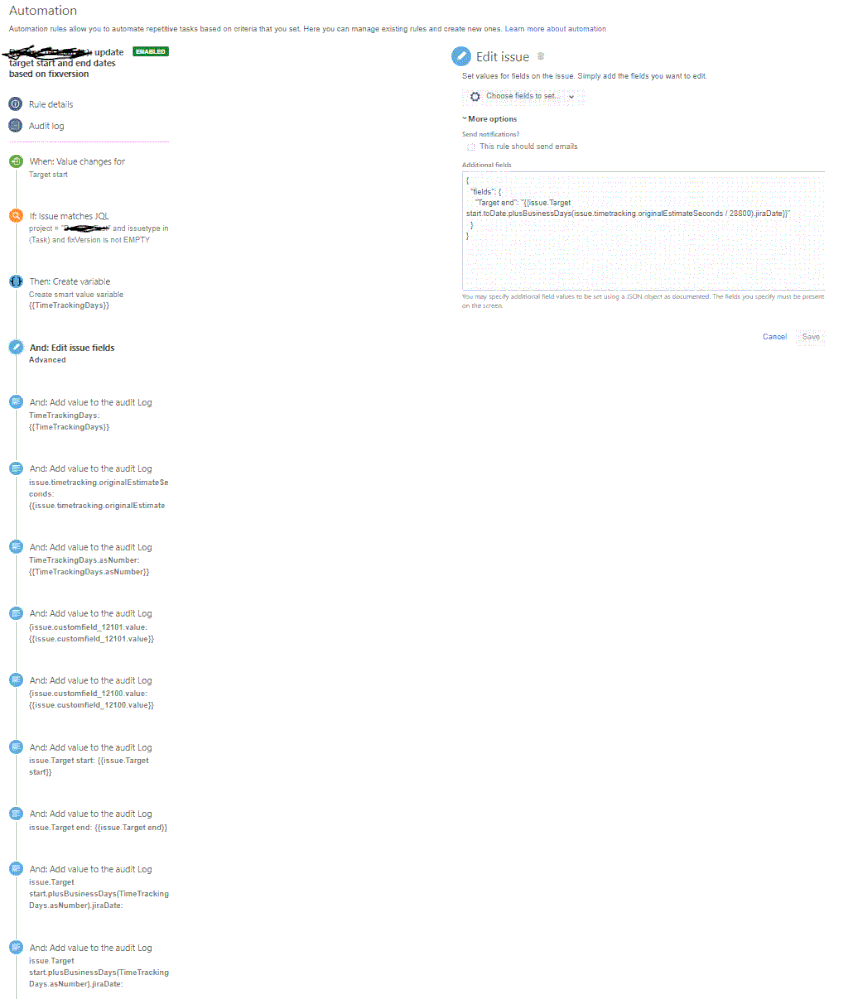

I updated the automation a bit, but this is how it is as a whole:

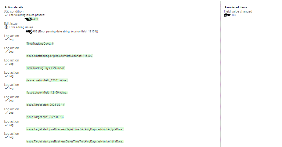

And the updated audit log looks like this:

"fields" : {
"Target end": "{{issue.Target start.toDate.plusBusinessDays(issue.timetracking.originalEstimateSeconds.divide(28800)).jiraDate}}"

Thank you for your answers, but I still don't get this working. The value in smart value TimeTrackingDays.asNumber seems to be "null" based on the Audit log entries (see screenshot below). Also the smart value with custonfield_12100 returns no value.

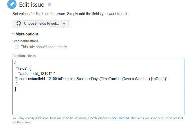

Here are the other screenshots. (Note, the customfield names are different here, as these are from my dev environment).
Rule details:
Edit Issue:
Audit log:
In the automation, I am adding these values to Audit log:

What is the type for your Planned Start Date and Planned End Date fields? Are they date picker fields?
If so, please try this expression first:
"fields": {
"customfield_120": "{{issue.customfield_121.plusBusinessDays(TimeTrackingDays.asNumber).jiraDate}}"
If that does not help, these fields could be ones which only provide text values to rules. In that case, use this expression:
"fields": {
"customfield_120": "{{issue.customfield_121.toDate.plusBusinessDays(TimeTrackingDays.asNumber).jiraDate}}"
While trying these, ensure the name of the created variable and the name used in the expressions match exactly. Smart values are name, spacing, and case-sensitive, and when an unknown one us used that evaluates to null.
