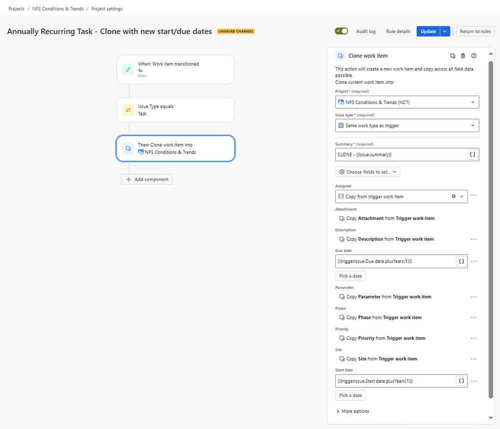

You can then use the Clone Work Item action to make a copy of the work item. It will be set to the initial status specified for that type of work item.
You can adjust the dates in the new issue using Smart values to specify a new date relative to the date in the issue that triggered the rule; i.e.
{{triggerIssue.Due date.plusYears(1)}}

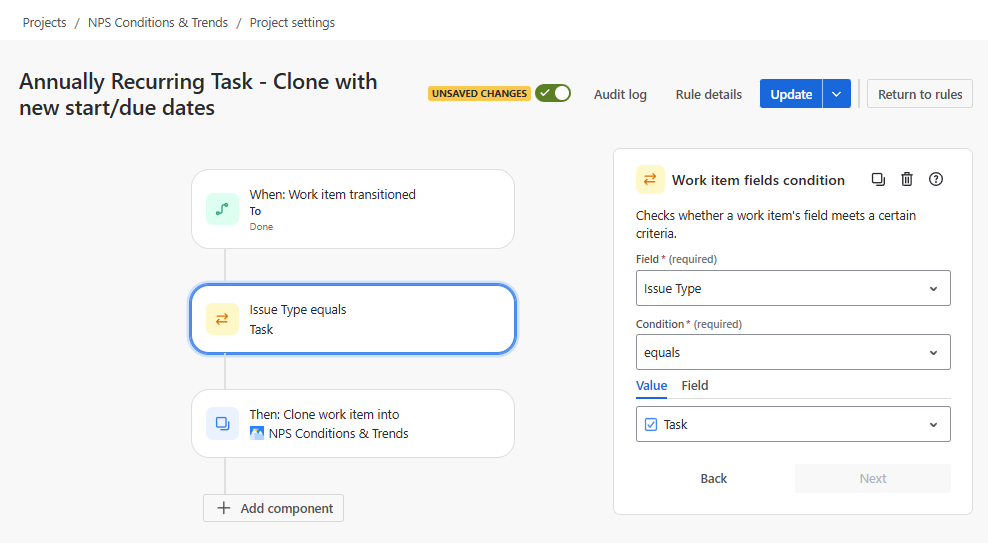

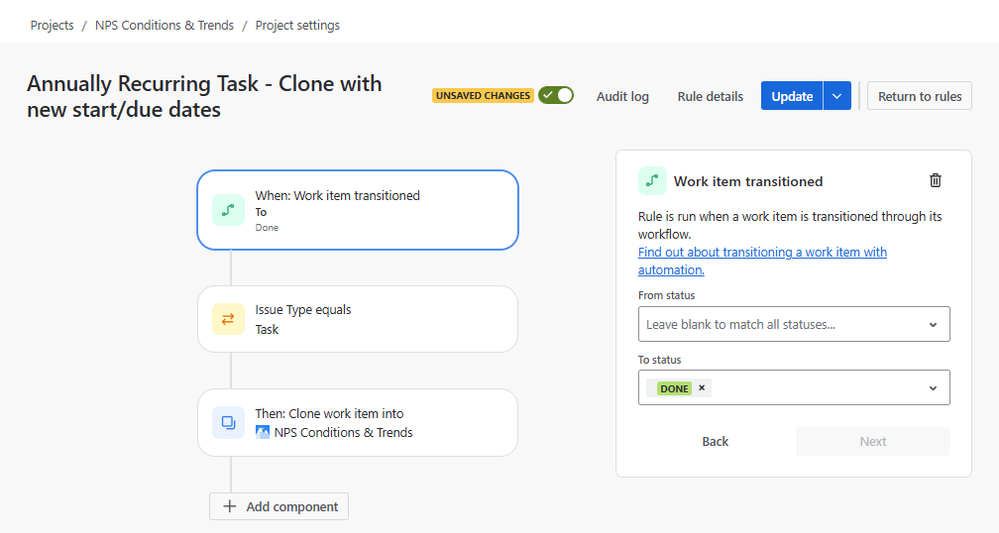

The rule is enabled. The project scope is the project within which the tasks live that I'd like to clone, which is the only one that I need the rule to apply to. I've added screen shots showing the details. Thank you so much for attempting to help a newbie like me!
