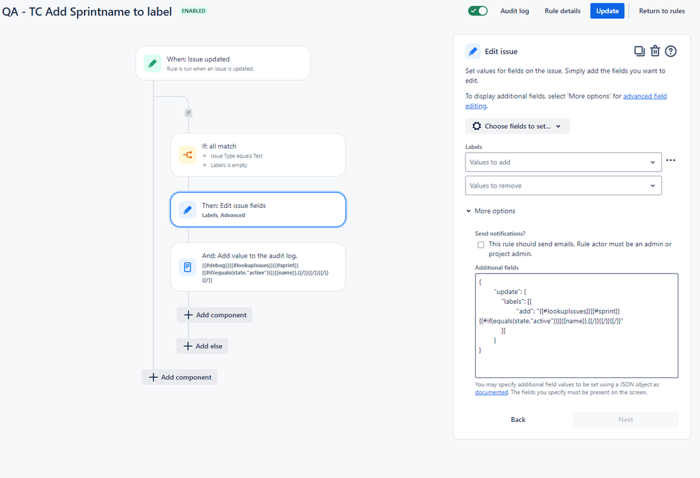

As requested here is a screen shot of my rule (updated now after your suggestions)
Screenshot 2024-04-20 080039.pngAs you can see I added in @Kalyan Sattaluri new suggested string from @Bill Sheboy 's reply. This unfortunately did not work either :( .

@Walter Buggenhout , I did briefly try adding
{{#lookupIssues}}{{#sprint}}{{#if(equals(state,"active"))}}{{name}},{{/}}{{/}}{{/}}
to the Labels field directly as an Add but got an "Additional fields contains invalid field(s) in 'update' or 'fields' section: Custom Field Name" error (see below)

You should have just started with rule screenshot so we did not have to go back and forth.
As you are not doing lookupIssues action in your rule and your trigger is "Issue updated" and is supplying the issue to the rule, so change your syntax to:
{{#issue}}{{#sprint}}{{#if(equals(state,"active"))}}{{name}}{{/}}{{/}}{{/}}
Log this, and assign to labels using advanced edit. Dont directly update labels field as Sprint name can have spaces and then you will end up with a mess.
Also, remove "Labels" from the dropdown selection aswell so as to not confuse Jira. You cannot have same field in advanced edit and the dropdown, it will throw an error.
Please confirm and if it works, else share screenshot of audit log. accept my answer in this thread if it works and also vote Bill solution on the other thread so that it surfaces in google search easily. Thanks!

As @Kalyan Sattaluri described with the linked thread, that smart value expression must first be put into a created variable, and then parsed to get the distinct values.  Please review the other thread to understand the technique.
Next, when using issue edit for a field, you may select the field or use advanced edit with JSON, but not both methods for the same field edit.  Please remove the Labels field from the dropdown, selected fields in the edit.
Finally, please remove the debug tokens when writing to the audit log: just write the smart value expression.  Debug is used when making a field edit with an expression, although I have rarely found it to be better / worse than just writing to the log.  The only valid use case I would consider is when a rule is approaching the 65 component limit, and so adding other audit log writes is not possible.
