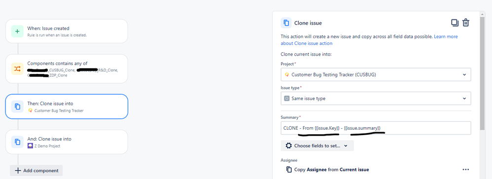

I'm currently facing  an issue with the summary display in my Jira cloud automation rule when cloning issues across multiple projects.
My Configuration:
  • Trigger: Issue created (Global Rules)
  • Added a condition : Components contains of X,Y,Z
  • Actions:
    • Clone issue with the following configuration:
      • Clone issue in Project B  : CLONE - From {{issue.key}} - {{issue.summary}}
      • Clone issue in Project C  : CLONE - From {{issue.key}} - {{issue.summary}}

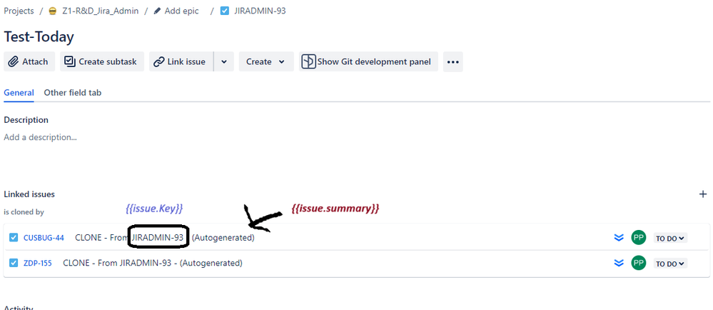

The issue is using the smart value {{issue.summary}}, the text into the cloned issue's summary continues to display as 'Autogenerated'.
Interestingly, when I use the smart value {{issue.key}}, it correctly displays the ticket ID into the clone tasks which are created across all projects.
Requesting to guide me and let me know if i am doing something wrong steps. Thanks in advance . :)

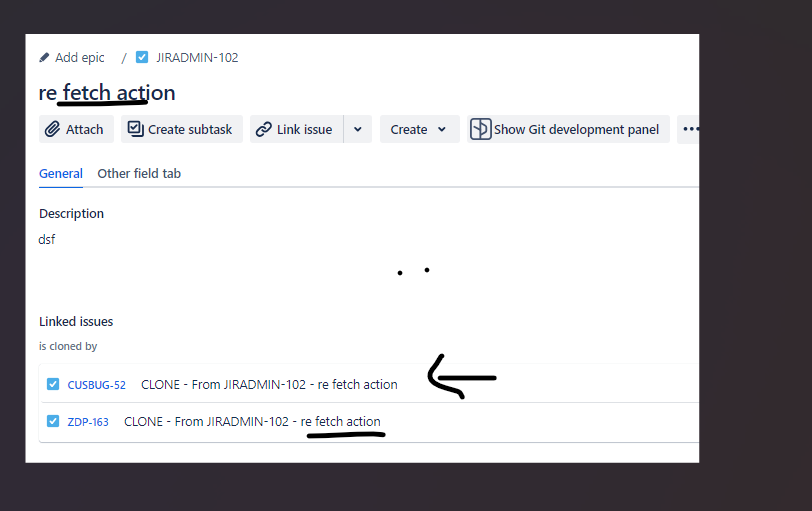

The Issue Created trigger can fire so quickly that some of the issue data is not available to the rule when it starts.  This will cause things like empty / incomplete fields when the rule runs.
To determine if that is the cause, and to fix this symptom, please always add the Re-fetch Issue action immediately after the Issue Created trigger.  This will slow down the rule a bit, and reload the issue data before proceeding.
Please try adding that action and re-testing your rule.
Bill
Purnima Pal February 6, 2024
Thanks a lots for guidance !! The above mentioned step works..

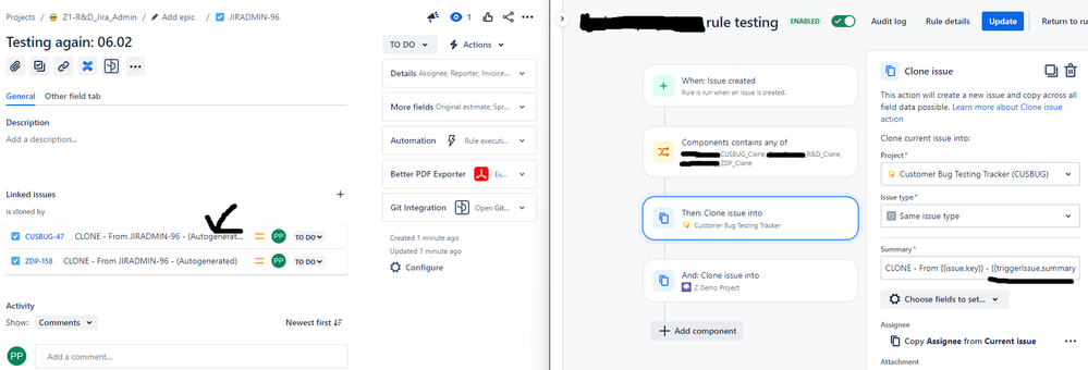

Hi @Manne Kjærby - ProProces  ,
Thanks for quick response . I tried the above smart value {{triggerIssue.summary}} , it seems the same 'Autogenerated'.
