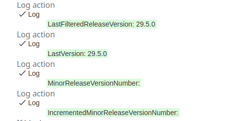

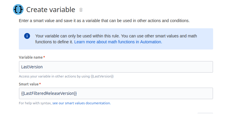

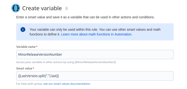

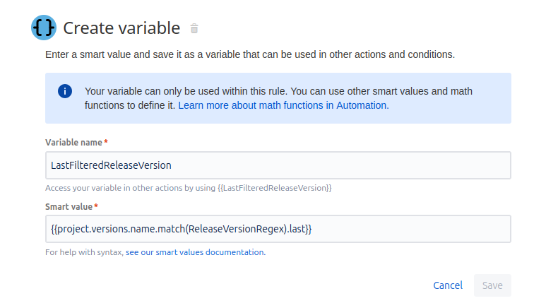

Im trying to split the string of a variable created in another step, but it is not working for me. I tried also the solution mentioned here , but it does not work for me.

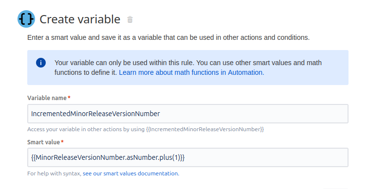

I want to split out the minor version number from a current last one and increment it by one, but it fails to get the minor version number with .split().
See my steps:
lastfiltered.pnglastversion.pngminor.pngminorincremented.pngIm also logging the value after creating the variable. This is the log:

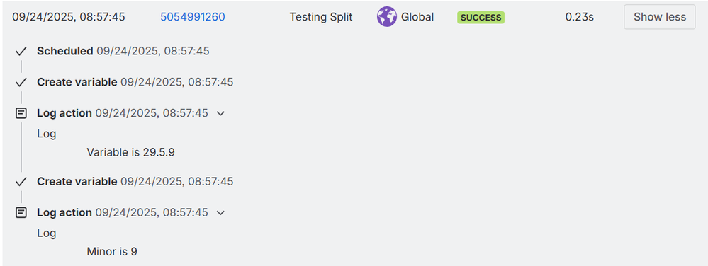

Thank you for posting your inquiry,  I started to test it as soon as I saw it and hit the same problem, checked the documentation and followed  the examples but still your same problem.
Later I thought to test with another character other than the Point (.)  and the Split worked, so I got from it that the problem is triggered by such character, so then I changed the split to use single quotes instead of doubles and it worked: split('.')
I used specifically: {{variable.split('.').last}}
Please give it a try and let me know how it goes.

Thank You, David!
Your suggestion with the single quotes worked!
