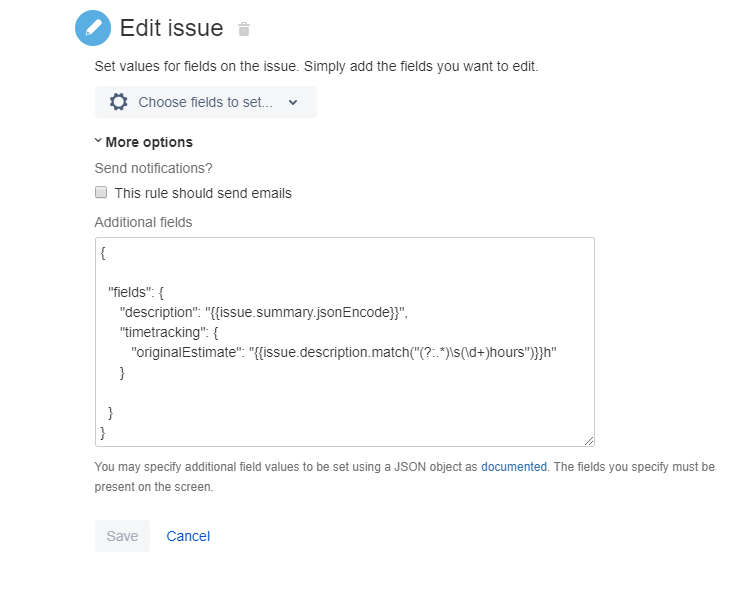

"fields": {
"description": "{{issue.summary.jsonEncode}}",
"timetracking": {
"originalEstimate": "{{issue.description.match("(?:.*)\s(\d+)hours")}}h"

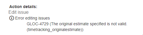

Hello, thanks for your answer Fran. unfortunately I get an error when trying to run it.
Description in the field:
In the automation rules it looks like:
Error:
The regex is prepared for finding the text after some other text, change it by deleting (?:.*)\s and It will find the 'xxxhours' at beginning of the line, if you add \s* it will find 'xxx hours' with or without space between the number and the word hours.
playing with the regex you can make this work fine.

Thanks Fran! I was able to make it work in all cases, thanks for the help and the recommendation on regex, will definitely have a look to learn more.
