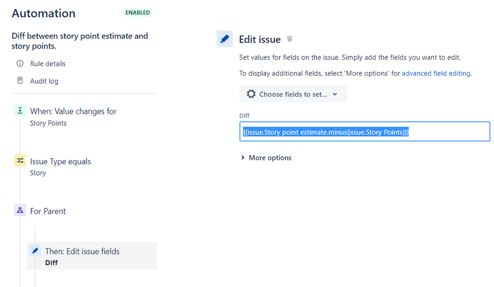

I have Story point estimate field and Story Points fields and result field named Diff to which I would like to have subtraction from Story point estimate and Story points.
In my jira automation rule smart value section I'm using
{{issue.Story point estimate.minus(issue.Story Points)}}
nor by adding {{#=}} front of it.
But it doesn't seem to work, what I'm doing wrong ?

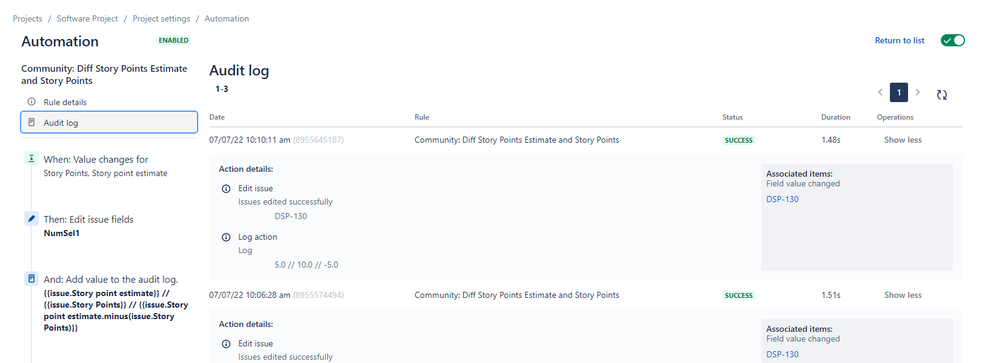

Hi @Jouni Riimala
I'm getting good results with the exact same code:
What are the results you are getting? Try adding a log action to log the values of the two fields, like I did in the above rule. Perhaps the Diff field is not in the edit screen. :/

Jouni Riimala
July 7, 2022
I didn't get any value due to my invalid process (now fixed). Problem was that when I did branching and thought that I need to get results to parent issue that was my major mistake. Did a while ago summing of sub tasks to stories, which somehow impacted to my thinking.
Thanks from your example and advice to use also
logging.
