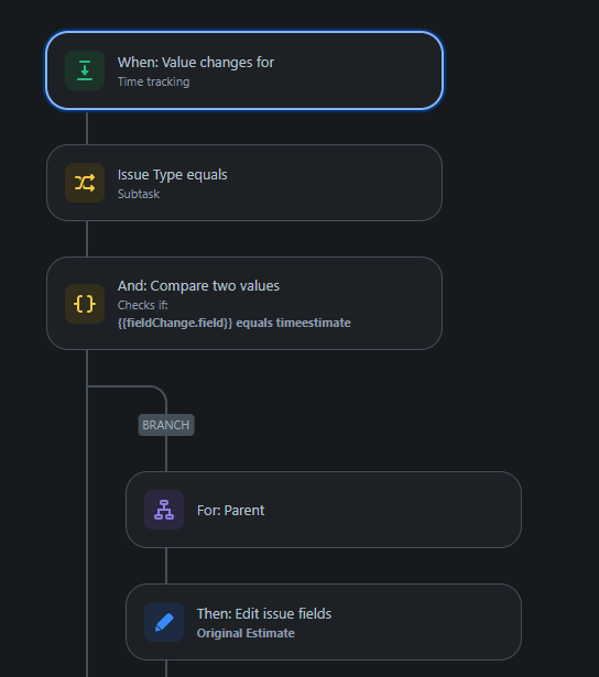

Here are the steps:
  1. Field Value Changed. Set Fields to monitor for changes to Time tracking then click next
  2. Add Issue fields condition, set Field to Status equals Subtask
  3. {{smart values}} condition, first value is {{fieldChange.field}} equals, second value is timeoriginalestimate → timeestimate
  4. Add a branch, set it to Parent
  5. Add an action, Edit issue and choose field Original Estimate then put this in the Original Estimate*
    {{#=}} {{issue.subtasks.original estimate.sum}} / 3600 {{/}}

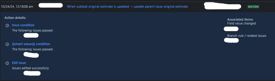

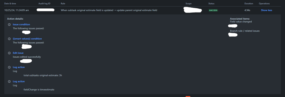

Here is the Audit Log that it is successful:

Here are the steps:
      Note:
  • there is a space between issue.subtasks.original [space] estimate.sum
  • If your project uses minute as the default time, then divide it by 60
    If hour, then divide it by 3600
    Since Jira calculates time using seconds.
For I don't know reason, Original Estimate is not available as the trigger in Field Value Changed. So I have to use a workaround solution, I use the Time Tracking field to monitor for changes. Then I set 2 conditions to match only Subtask issue type and Original Estimate is changed.

Here is the proof that it is working in the Audit Log:
