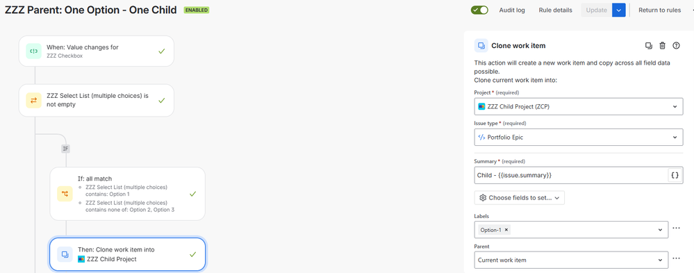

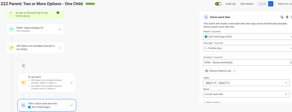

I have configured two jira rules in Jira Cloud as below.
Problem: When selecting only one option (Option 1) in Select List (multiple choices) on Parent, two Child issues are created instead of one.
I want that:
- If user selects Option 1 in Select Field, Only one child should be created via Jira Rule 1
- If user selects Option 1 and Option 2 in Select Field, Only one child should be created via Jira Rule 2. (It should ignore Rule 1 in this case)
Jira Rule 1:
Jira Rule 2:
Please provide necessary steps/ conditions/ screenshots to setup the required Rule config, to achieve the requirement.

To ensure consistent behavior, I recommend solving this scenario with one single rule, and using the different field change smart values to detect what was added rather than using conditions.
https://support.atlassian.com/cloud-automation/docs/jira-smart-values-issues/#--fieldChange--
Using a condition test the current value(s) of the field, and thus other changes to the field could lead to creating duplicate work items from multiple rule triggers / executions.
Specifically, if a person selects one option and even briefly leaves the field, returning to select another option, that will trigger the rule multiple times.

Honestly, I am still unclear on what problem you are trying to solve with this rule by checking so many values.  That is, "why do this?"
Until that is known...
Logic which tries to check so many values and span the checks across multiple rules is often a brittle approach.  The reason is multiple rules are separate and the conditions must be mutually exclusive to prevent overlaps.
Additionally for what you describe, there is a high risk the actions to create new work items will happen every time the field updates unless the change log is checked.
Let's assume for the moment your field option values help decide some specific data in a new work item, such as the Summary.  In that case, the rule could greatly simplify:
  • limit the field updated trigger to only look for additions
  • create a Lookup Table to map the field options to the Summary values
  • use the field change smart value to identify the additions to advanced branch for each one
    • and then create the work item with the relevant Summary from the table
Thus a rule to handle 30 options would only be 4-5 components long, instead of longer than 65 components.
