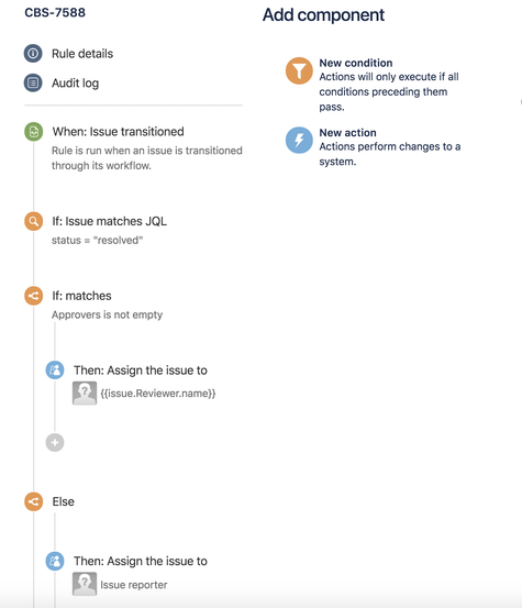

There is an easy enough way for Automation for Jira to do what you need.
I have attached a screenshot which walks you through the steps. (Just keep in mind that I have used the field 'Approvers' instead of 'Reviewers' in the example as this is your custom field.
Let me know if this works for you or if you have any further questions!

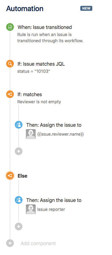

Thanks a lot for your answer! This is exactly what I was looking for, and here's how I configured it in our case.
status = "10103"
This is "In review" status ID. However, for some reason it conflicts with some other rule that we have in automation.

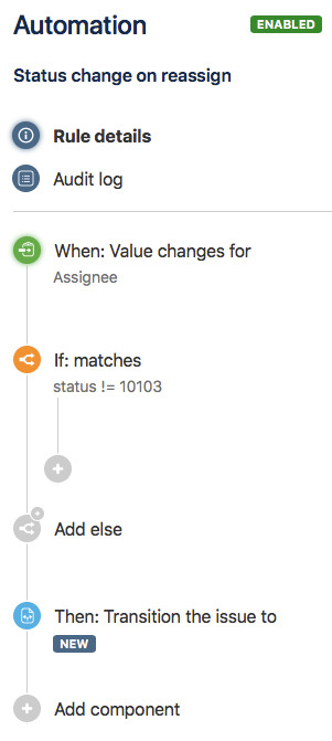

This rule states that whenever assignee of the issue is changed, status should change to "NEW". I've added != condition for issues with "In review" (10103) status, so that it won't conflict with the rule above. However, there're cases when issues are left unassigned, or transition to "NEW" status even from "In review". What do you think may be the reason?

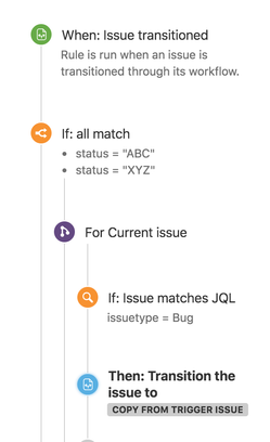

Yep - exactly right with regards to your first question. You can add two more conditions. (You can either use the 'compare two values' condition or the 'Issue matches JQL'
If you want to keep your rule that bit cleaner, you could use the Else / If block which will enable you to use multiple conditions in one. I have attached a screenshot to give you an idea of what I mean.
Secondly, if you want to create a rule for specific issue types, all you need to do is add a condition to check the issue type so it only executes on the issues you want. I have also included a sample of this in the second part of the sample rule screenshot.
