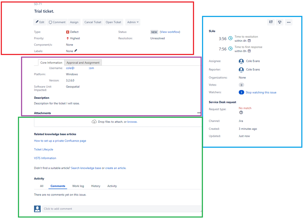

Today I looked at the current state of the jira service desk tickets and I am not really thrilled with the information deluge I am hitting people with.
Where can I find the configurations to modify each of the sections?
Like in my mind red = "header".
"Purple" = general screen configurations I believe, it seems to have taken the same settings as my input screen.
"green" = some default ticket screen, "footer"?
blue = some default again, "side bar?"
Advice on where to find these in the configurations would be greatly appreciated. Feeling a bit like I am drowning looking through the config haha :x

Hi Cole,
You can edit those under screens.
Wherever you are, type 'gg', and then search for 'Screens'.
It'll probably be under 'SD: Jira Service Desk: Change Create Issue Screen', or something to that effect for you.
That covers off red and purple.
Blue - you can modify some stuff by editing the screens above, but most of it will stay.
Green - what do you want to remove?
You can turn off log work, and potentially Activity by disabling some modules, but that gets messy.

Thanks for all of the information Jimmy!
I thank you for the information, here I was running around like wild trying to figure out how to get rid of these.. I suppose service desk cloud really does like keeping things a certain way. I don't mind most of the fields in green, I just wanted to filter it down to be even more simple-- not that it's too bad, we can do it!
I greatly appreciate all of the information, you saved me so many hours of searching around!
