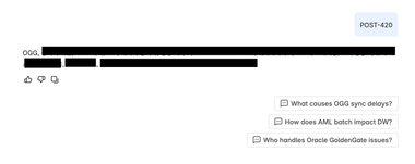

However, I'm seeing a difference in the response when I give the prompt TEST-111 to the agent through Jira Automation versus when I give the same prompt in the Rovo agent's chat interface.

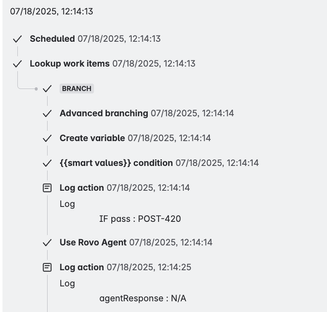

  • In Jira Automation, the agent returns N/A, as if it can't find the information.
  • In the Rovo Chat, the agent correctly returns the keywords as A,B,C.

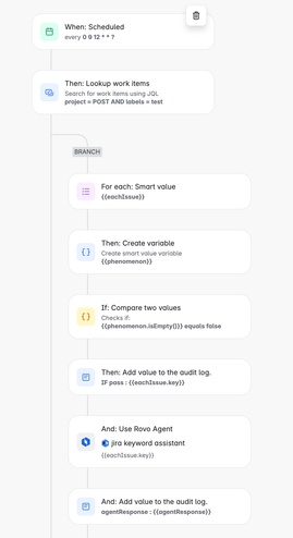

Here is my rule and audit log and chat.
I hope this provides the clarity needed to diagnose the symptom. Please let me know if you need any other details from my end. Thanks again for your help!

I have seen questions with timing problems with Rovo agents where first storing the {{agentResponse}} in a created variable allowed better access, although I would not expect that to be a problem when logging the value.
I recommend working with your site admin to submit a ticket to Atlassian Support to take a look: https://support.atlassian.com/contact/#/
