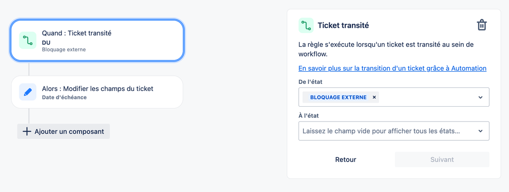

Eric Brandenburg August 14, 2024
Thanks to both of you, I got a "success" on that automation but the result is not the one expected.
My custom field is already a date fiel so it works fine as it is without the "toDate".
{{now.plusDays(issue.duedate.diff(issue.customfield_10246).businessDays)}}
which in calculation should look like that :
{{14/08.plusDays(issue.15/08.diff(issue.12/08).businessDays)}}
But the calculation went wrong :
I had :
due date = 15/08
start of blocked ticket = 12/08 (my customfield_10246)
So the result expected when putting the ticket back in the "in progress" column was due date = 17/08 but I got due date = 11/08 instead
