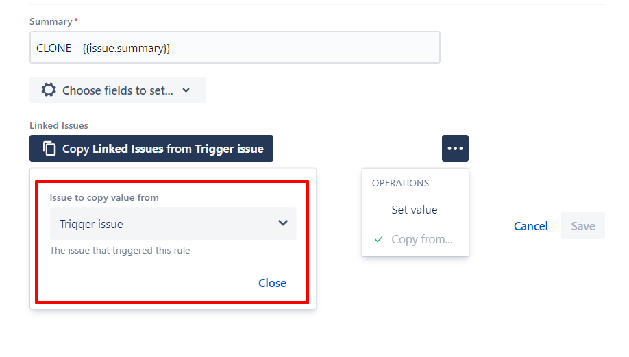

I'm trying to clone an issue using Automation for Jira. I want the new issue to include all the links of linked-issues from the original issue.
This is not possible using the automation interface and may be possible using the "Additional fields" using JSON.
I tried already to use the "Additional fields" but I succeed in adding only 1 link from the original issue. If the original issue has more than 1 link - it seems that iteration over the {{issue.issuelinks}} doesn't work.
Can someone help?

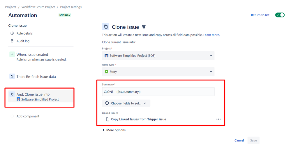

Hi @Elyashiv Grosser
Welcome to the Community!!
Assuming the problem is statement is below
Can you try the below and let me know
Pramodh
Pramodh M
January 30, 2022
FYI, this is the option
Elyashiv Grosser January 30, 2022
Hi!
I'm feeling so stupid, I didn't see that option.
Thank you very much!
I tried for a long time something with a such simple solution!
