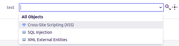

Is there a way to get the Insight custom fields from my Jira's instance API with its objects according to their object schema?
E.g. I have the following Insight custom field named test and when I'm creating a new issue I can see all the objects available according the Object Schema that I selected in the configuration:
Is there a way to get this information (the Insight custom fields with its objects) from the API? I know that I can get all the objects from a specific schema by using the endpoint /iql/objects?iql=objectSchema="SCHEMA", but what I want to get is the custom fields with its objects.

If a custom field has multiple values to choose, it will show me the field "allowedValues" with the values for the custom field, but this doesn't happen when it's an Insight custom field.

That's an interesting question.
It's possible that the IQL defined in the custom field context is only used for building the UI and not validated at all in the back end. This might imply Jira API will allow you to input any object via the rest API. I'm not even sure if the object key is validated to make sure it is valid.
But that still leaves you not knowing what are the possible values.
I checked and I can't find any public insight or Jira rest API that can give you the configuration for a custom field context (that would let you get the IQL so you could use the main insight API to get the list of objects).
I can find an internal insight API that can return the IQL, but you would first need to identify the correct config id for the issue context (project and issue type). But there are no public APIs for that either.
The insight internal API is:
/rest/insight/1.0/customfield/default/<custom field context id>/connect
If you have Scriptrunner, you could create a custom Rest API that can use the JavaAPI to get this information.
