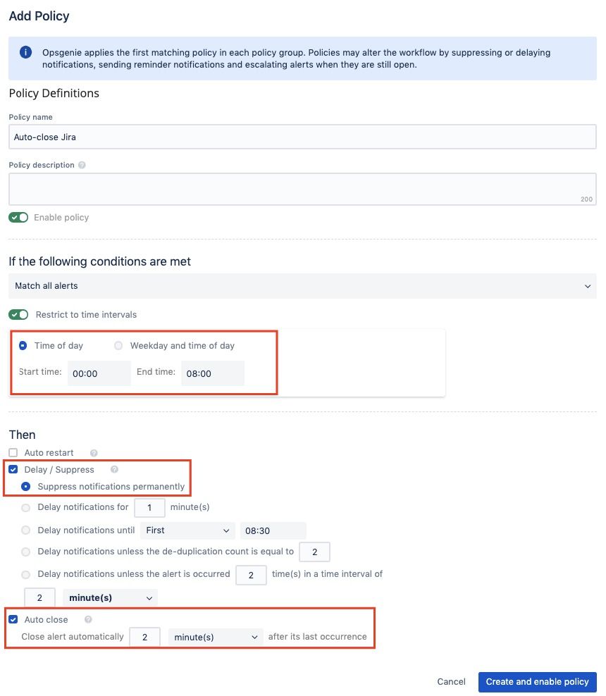

Unfortunately not only for Jira, but also for other integrations putting time frames as a filter is not option right now. However, as a workaround, I could recommend you using Notification Policies.
Basically, notification policies allows you to suppress/delay/auto-close alerts if they match with your defined conditions, also you can put time intervals so when an alert is created in Opsgenie, creation time will also be checked by your notification policy - see attached.
Do you think that workaround would work for you?

I had a look at this too. I think that's just a time-frame for the Policy selected. It's not a rule that restricts incoming Alerts to that time frame. It would have been a good feature to use if it actually automatically closes/deletes alerts on certain time frame but I don't believe it allows that.
