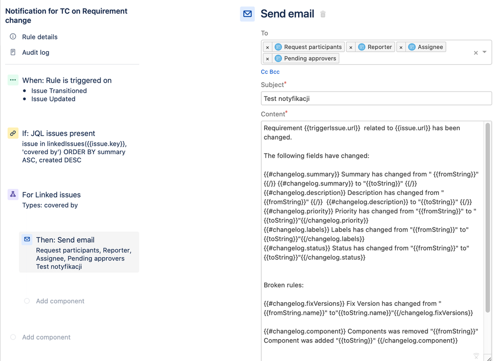

I am trying to set notification about changes on related issues.
I succeed to get the previous and current value for Summary and Description and few other fields but I can't do the same with Fix Version and Components.
Here are the values I am trying to use.
{{#changelog.fixVersions}} Fix Version has changed from "{{fromString}}" to"{{toString}}"{{/changelog.fixVersions}}
{{#changelog.component}} Components was removed "{{fromString}}" Component was added "{{toString}}" {{/changelog.component}}
Unfortunately, it doesn't work. Does anybody have the same problem?
Thanks for the help!

Hi @Jarosław Solecki _Deviniti_
Did you notice that the fields not working for you, Components and Fix Version, are both list fields?  I did some rule testing and what I saw was:
  • Components sometimes worked
  • Fix Version never worked, even when using fixVersion.name to go inside the item
  • And Labels always worked
There seems to be a defect (or undocumented behavior :^) for changelog and list field processing.  Until someone from Atlassian who worked on this (former CodeBarrel folks) comments, I suggest submitting a defect through your JIRA instance admin:

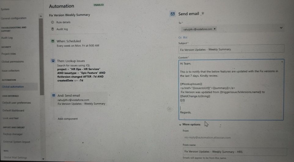

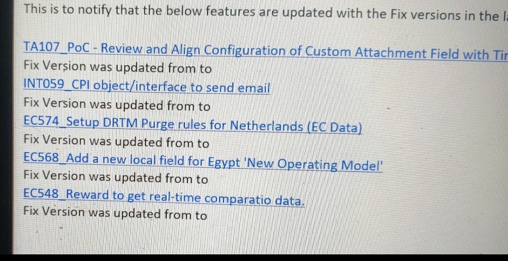

Rahul Jith August 30, 2022
Hi @Bill Sheboy ,
Thanks for the support as always 😊
I have kept a lookup which captures the issue changes in last 7 days,(2nd rule in my screenshot) which is printing me the correct issues which are changed(2nd attachment). But, my main intention is to print this issues along with the details of the fix version changes.(from and to).
Going through your email one doubt arise in my mind that if I keep that lookup condition within the scheduled as a query will this issue be resolved. (Deleting the action in Lookup).
Regards
Rahul Jith
Hi @Bill Sheboy ,
Absolutely agree with you. It was a blunder I did with the scheduler as trigger. Yes I totally understood the reason. Thank you so much  Bill on detailing it and make me understand. Much appreciated on your prompt support.
Now with the trigger as issue field value changes, I have tried with changelog and fieldchange options and still getting a blank outcome.
Below are the tested failed scenarios
 1.
{{#changelog.fixVersions}} Value updated from "{{fromString}}" to "{{toString}}"{{/changelog.fixVersions}}
2.
{{fieldChange.field}} field was updated from {{fieldChange.fromString}} to {{fieldChange.toString}}
3.
Changed value- {{triggerissue.fixVersions.name}}
Changed from- {{fieldChange.fromString}}
All the above 3 failed to print the fixversion change history. kindly advice if any workarounds can sort this issue.

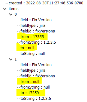

Short version: this may not be possible with an automation rule due to the way the REST API captures changes to a list field.  This seems to be the specifics of the defect @Jarosław Solecki _Deviniti_  noted in this thread.
Longer version:
  • I retested with Jira Cloud, using several scenarios of add/remove, and single/multiple values of fixVersion
  • In an automation rule, the {{changelog}} smart value was not consistently able to access the previous value for fixVersion
  • In an automation rule, the {{fieldChange}} smart value was not consistently able to access the previous value for fixVersion
  • Calling the REST API for change logs (issue history) seems to explain why rules have difficulty...
    • The adds and removes from a list field are logged separately.  For example, changing one fixVersion for another creates 2 entries:
  • one entry shows From: old value and To: null
  • another entry shows From: null and To: new value
  • the entry order seems inconsistent, and not one predictable order, such as remove then add
  • Other types of field changes seem to only create one change log entry
  • And so perhaps automation rules only ever look at the first change log entry found
I am unclear how a rule could be written to aggregate/summarize the multiple change log entries for the reporting you want: it would need to handle 1-to-many possible change entries.
