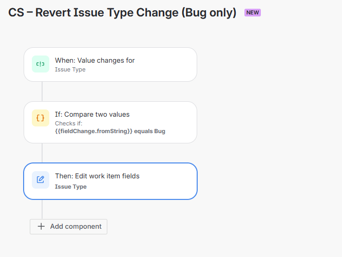

Christos Markoulatos
October 14, 2025
Hey @İclal Aslan
try something like this:
hope it helps!
İclal Aslan
October 14, 2025
Thank you. But when I edit the issue typw how can i make sure it changes to the old issue type?
