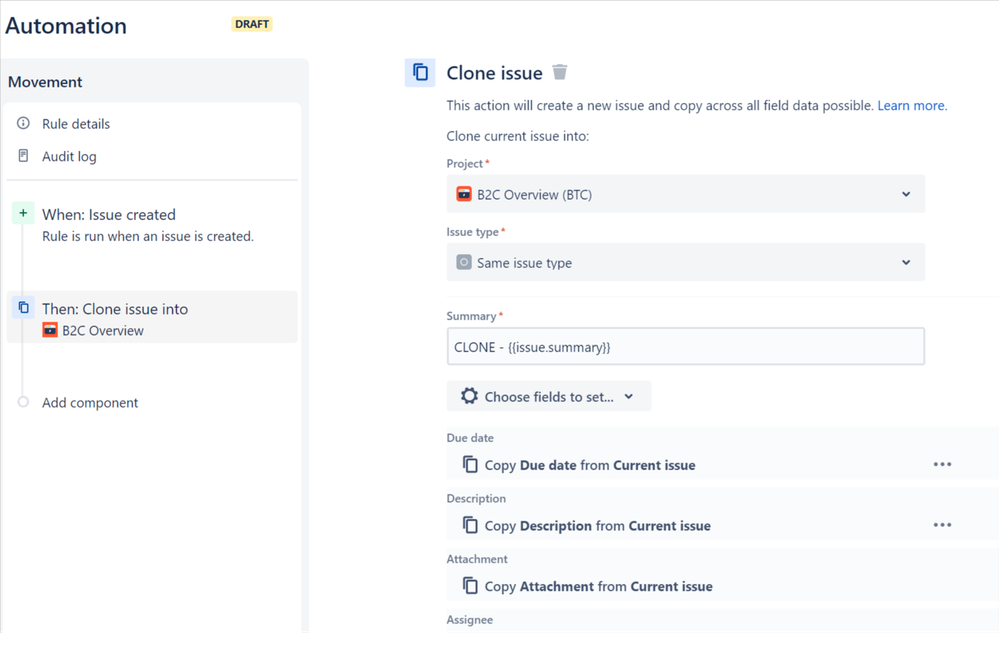

Yes, that is very easy to do with an Automation Rule. Create a rule based on an Issue Created trigger for the JSM project. Then add any conditions you need so that it only executes for the appropriate JWM project.
Then add a new action for Clone Issue. Change the project to your JWM project and any other information that needs to be added or is different from the original request.
Then add a new Action to Link Issue.
After that, same and publish the rule.
You will need to create a second rule that keeps the Linked issues in sync.

I was able to execute the first part of your answer but could not figure out how to execute the following while creating the automation rule -
Then add a new Action to the Link Issue.
Could you please guide me on how I can execute the remaining part of the automation rule that you mentioned in your answer?
Thanks in advance!
Thanks again John, finally it links the two issues across JSM and JWM.

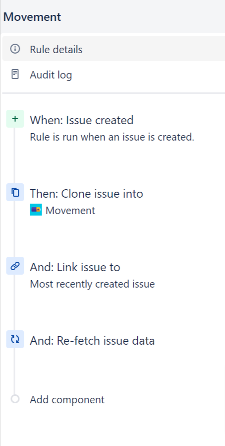

Hi John, based on your comment I created the following rule in the JSM project from where I want queries to get cloned to the JWM project.
New queries logged in JSM are getting cloned in JWM but sync is still not working and in audit log of the rule the following message is displayed -
Am I missing something here or do I also need to create some rule in the JWM project where the JSM query is getting cloned?
Thanks again for all the input 👍
